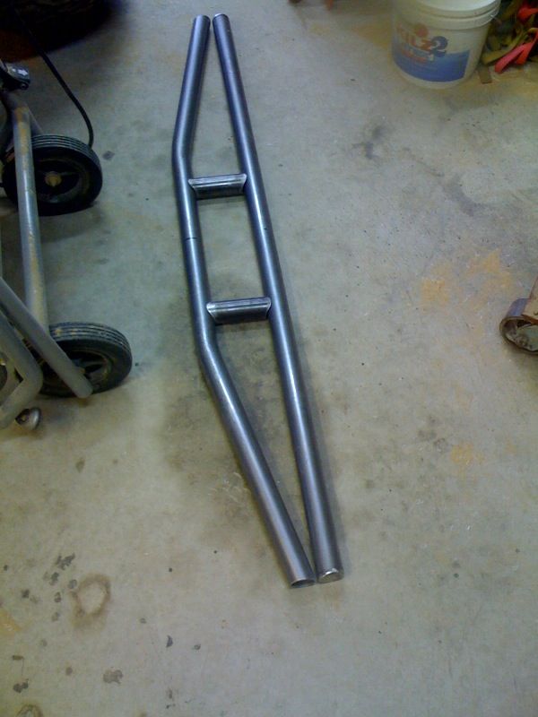

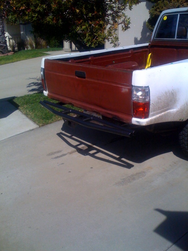

    started working on a rear bumper. just need something simple. will have a hitch also.
    :rant: stupid IMS sells receiver stock. got that cut it so it would fit and drilled a hole for the receiver. and what do you know, its not really the right size. the corners are a little to round and none of my receivers fit. they will fit if i use a sledge to make them fit :lol: weak :/rant:
    well, heres the pic. the receiver stock will go under it and have some braces. i think i will also run some tubing from the back of the receiver to the frame. Now i know this isnt going to be towing some crazy loads, just some bikes and maybe a jetski.

  25. #65
    Senior Member paranoid56's Avatar
    Apr 2008
    San Diego, CA
    1,395
    finished the bumper, but think i might add some ore tubes to it.

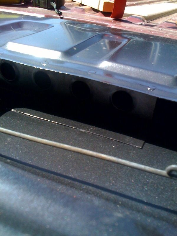

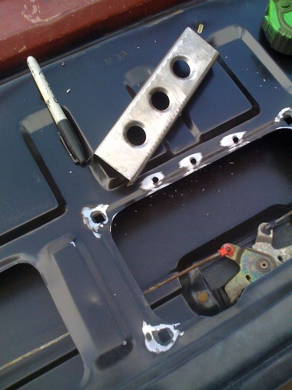

    did a little work on it today. i picked up a new tail gate for it as the stock one was rusted though and wouldnt hold anything on it.
    the new one is nice looking however is super thin and flimsy. so figured i would add some gussets inside of it. just simple 18ga steel with dimples. welded to the panels.
    and installed.

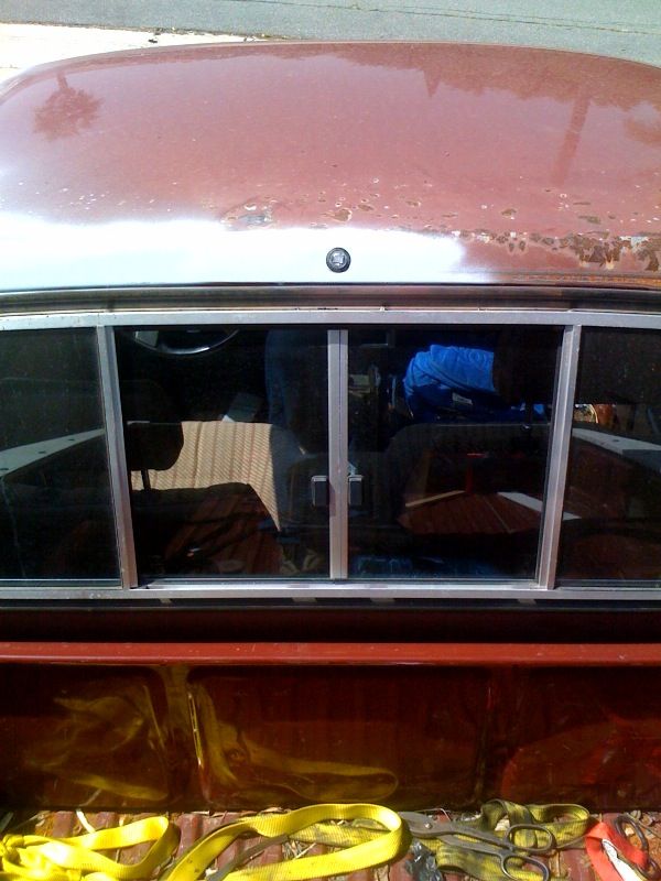

    also worked on the roof a bit. the PO took off the stock light that was there and left 3 open holes. so i welded those up and drilled a hole for a simple 3led tail light. didnt want to go to crazy and this should work well.

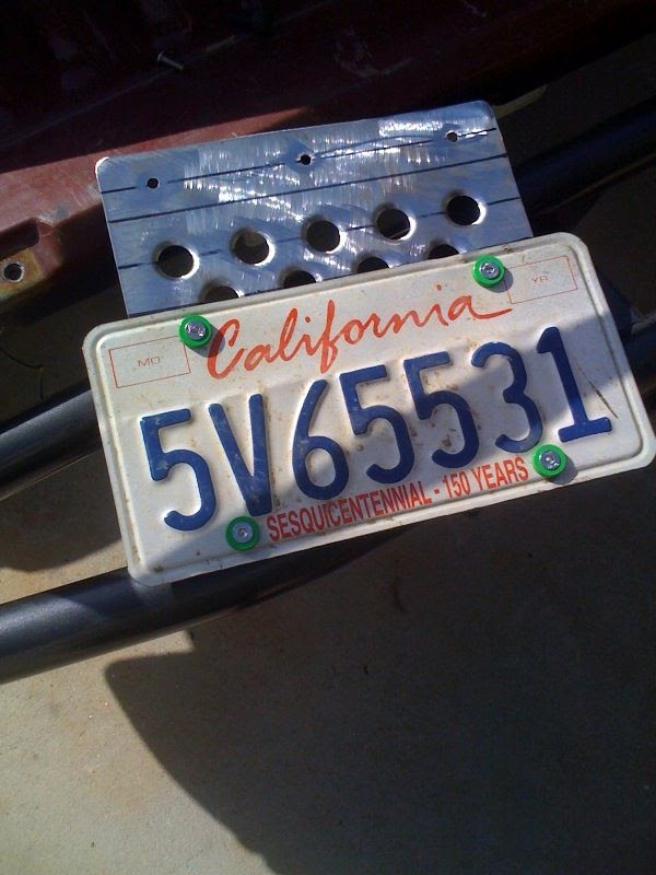

    needed to fix the plate also. had it zip tied under the truck. so needed a simple bracket to hang it off the back of the bed but under the bumper. not sure i like it, but it gets the job done. also added a DOT LED light to light it up nice and bright for the popo.

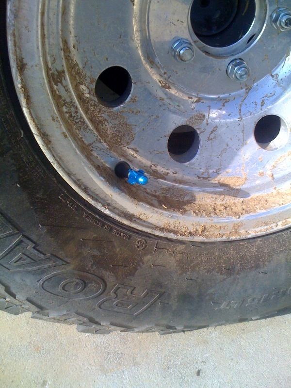

    Also added these super sick knar valve stem caps. only had two so they are on the drivers side

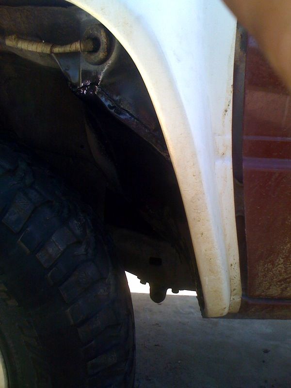

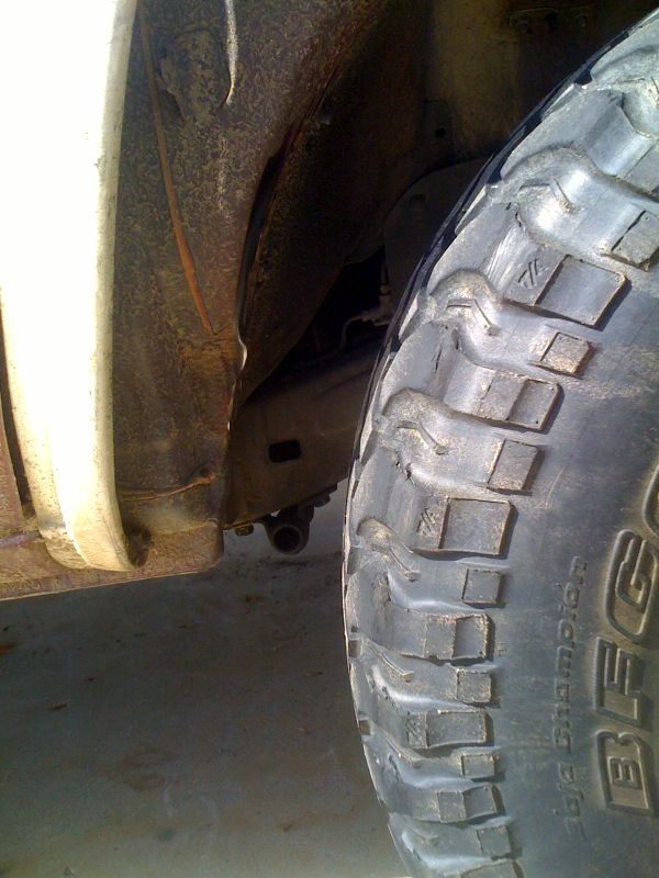

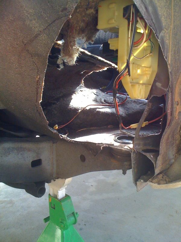

    Got tired from the tires hitting the firewall so broke out the cutter
    and the huge ass hole thats now in my firewall. i gained almost 3 inches on the back side. not to bad.

    finished up the drivers side. only caught the carpet on fire twice. so not bad overall
    and the passenger side to show the difference. gained quite a bit of room.

    lets just hope it doesnt crack. my floor on the passenger side is splitting where the firewall meets the floor. wonder what cutting all that out and redoing it did as far as strength.
    "...but why quit what you love for a situation?... I don't ever want that or want that for anybody but i can't stop my life because of it" -Ricky Johnson
