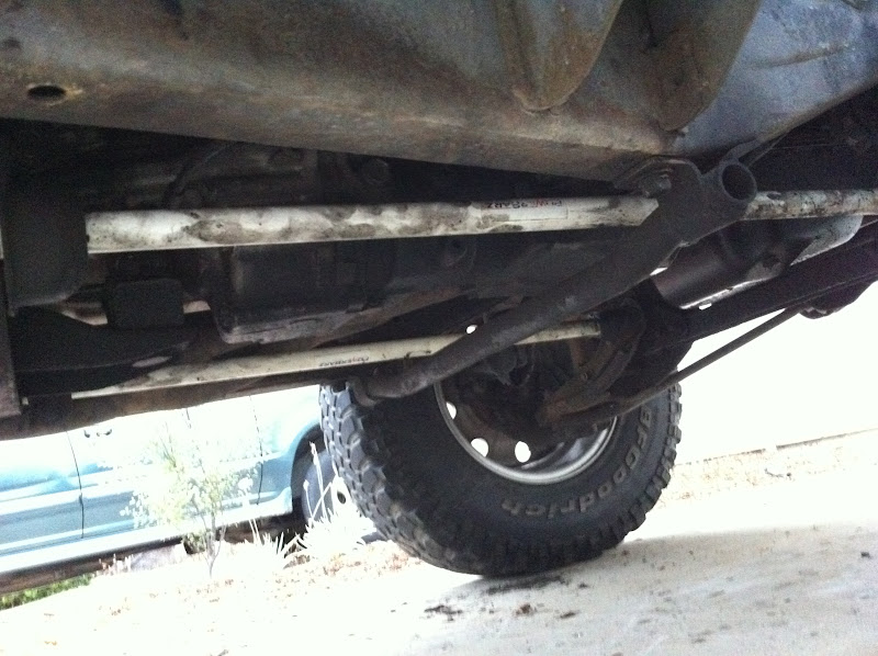

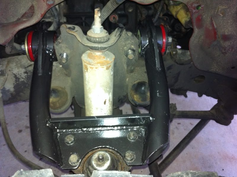

    hmm, damn these torsion bars are greasy LOL. should have cleaned them after install. but this should keep the rust down
    and a pic of the new upper arms. and yes, those are the new KING shocks LOL super sick
    my first truck was an 86 with the same suspension you have. it by far has been my favorite vehicle. i beat the shit out of it like i was robby gordon or some shit and it always got me home. i miss it baaaadd!!! cept i had some ranchos up front. they didn't last very long lol.

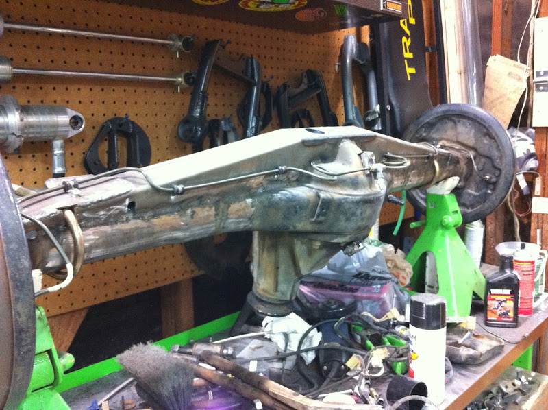

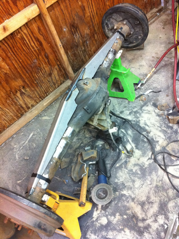

    little better pic of the rear truss. got all the brackets cut off and ground smooth. that shit took for ever lol

    maybe i missed it, what truss is that?

    Quote Originally Posted by 84prerunner View Post
    its a sky manufacture one. i think poly sells them also, i just chose to go to the source to save tax LOL. had it at my door in a few days. i was going to just build one, but sometimes i would rather spend the money then the hours and hours trying to make one perfect like this.

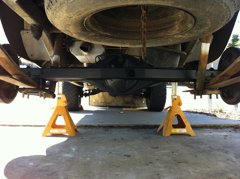

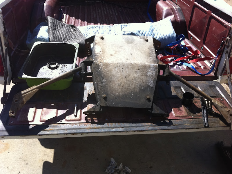

    well finished up the brakes and truss on the new 8" rear axle. waiting for some rims to show up so i can swap it over. also wile at the junk yard saw this kit on a truck so grabbed it, will probally use it as a base for my new lower arms.

    that looks to be a downey strut frame and skid plate, have one of those skid plates sitting in my garage.

    whats the benefit of having the strut frame on a stock arm truck?

    i really have no idea LOL. its just something i saw at the junk yard. the truck had bilstiens (yellow body) shocks on it, low pro bump stops and a huge downey sticker on the hood i tried to get the shocks and bump stops but didnt really bring the tools needed to get those items. only went to the junk yard to pick up some brake fittings. i barley got the arms off and luckily the frame was already laying on the ground.
    I plan on using the strut frame for my long travel kit i am building as its one less thing to make. looks some what similar to the TC ont.

    a strut frame on a stock truck will do nothing other then be stronger, ive hit rocks and and stuff with the strut arms more times then i would have thought. once you get low-pro bump stops and get a little more travel out of it they done bind up like the stock bushing pivot does.

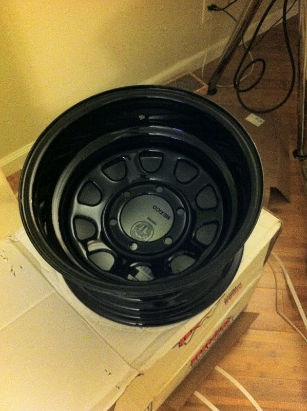

    my standard black rockcralwers. have them on my fj40 also, the black D spoke wheels, orderd them with 2.5" backspacing LOL

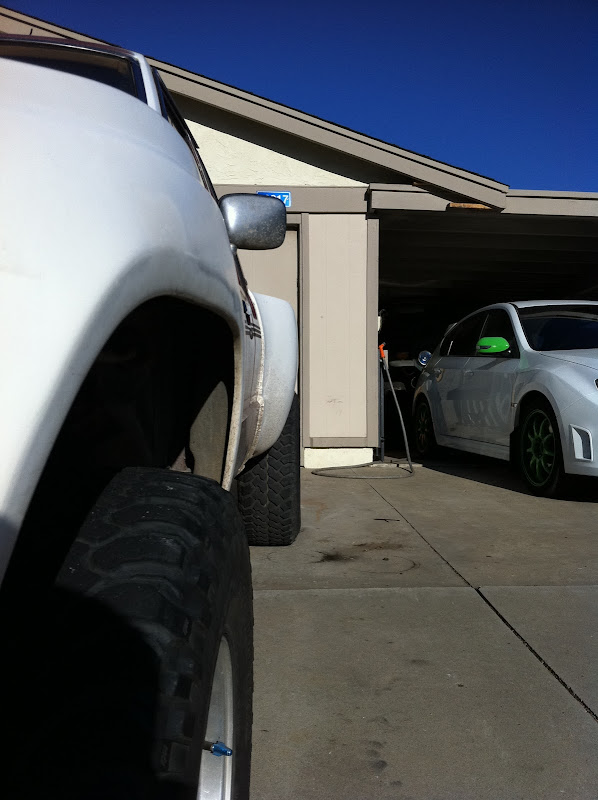

    Just 2.5? is that going to rub on the bed with a bit of flex in the back?

    just? stock i think is like 4. so it should push the wheels out around 2 inches. hoping it will be real close to the fenders. i dont think it will rub, as currently the new axle is maybe 1.5" wider, and i am running 2" wheel spacers on the stock axle and i still have almost 2" extra room. so with no spacers i should be close but not touching.
    well i hope so at lease LOL

    woot, rims showed up. hella deep dish yo LOL

    kinda like poor mans wider stance LOL. i am only planing on making 3 over arms. i have these same rims on my fj40 so kinda like having all the same.

    well axle is sitting under the truck. just need to bolt it all up tomorrow. with the new rims, edge of rim to edge of rim its around 6"+ft wide
  31. #151
    A.M. Fabrication 84prerunner's Avatar
    Feb 2008
    Covina CA
    15,065
    Quote Originally Posted by paranoid56 View Post
    damn, even my front LT kit is only 74 or 75" wide on the front. rear is 69. offset my rims sucks for making it wide but it nice for scrub and wheel bearings.

    yea, figured it might hurt the front, but front is curently running 2" wheel spacers anyways LOL. but this is just for the rear at the moment. so my scrub is allready shit and its been fine so far. wheel bearings i dont worry about that much about as i am upgrading to the 4x4 spindle soon. also keep thinking about 37s lol that way both my truck and fj40 share the same tire size lol

    and the new axle under the truck, still waiting for my damn tires to be mounted.

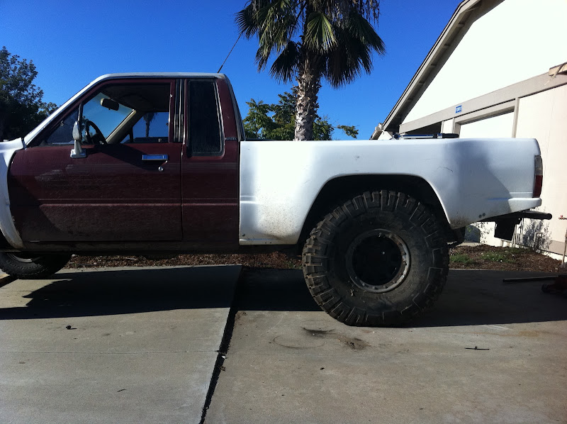

    hmm, not sure the 37s are going to fit, might need more lift

    pic with the new rim. yea, shitty pic.
    and one showing the width of the rear axle setup.
