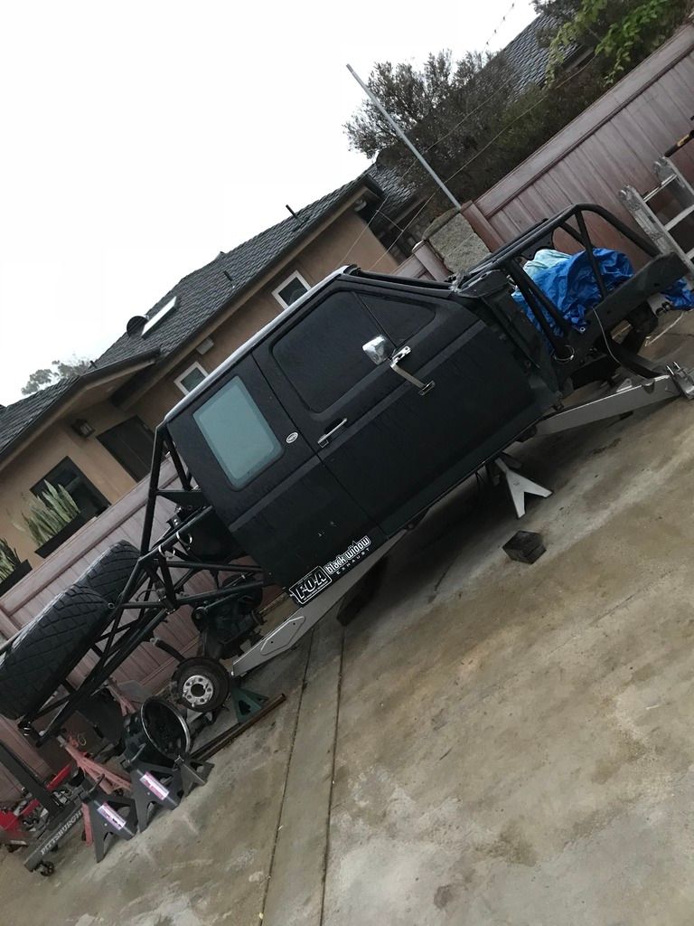

A few months ago I decided to give up on my f150 in the middle of an LS swap and sell it as a rolling chassis minus shocks as is. This is how the truck sat

Ok just making sure I still know how to post pictures on here lol. So I had a lot of interest in the truck when I was offered a “partial trade” for this shitbox ranger. He offered to give me what I wanted for the f150 chassis and threw the ranger on top to please his girlfriend.... Dude sent me a couple pictures and the beam kit looked usable so I said whey not. This is how the truck sat right before I dragged it out of the field it had been sitting in for the last 2 years. seats sitting on a peice of wood. horrible mild steel engine cage but it had kings bro! so after dropping off the f150 I loaded this pos ranger onto the trailer and took it home. At this point I had all the shocks off the f150 and a ranger with a beam kit that looked semi usable.
Plans with the truck are to keep it simple. A lot of the reason for getting rid of the f150 was money. I didn’t have the kind of money for full floater rear ends and the type of power it takes to move a 6000lb+ truck around. Plan is to keep the ranger simple with 4.0/5 speed(s) and 9 inch flanged housing. Just something I can take out and be reliable with and hopefully get 4-5 trips a season without having to tear the truck apart.
First thing was to remove all stock interior parts and sheet metal.
Next I picked up 700 feet of 1.75 .120 4130 chromoly. The whole truck front to back will be 4130.
Started with the base of the truck wich is the cab cage. Engine cage and backhalf will be built off this so it seemed like the best place to start.
once everything was shared up the tubes starting flying

Got the whole roof section done and burned it in then dropped down for 360 welds
The start of the back wall
Got the main section of the cage all done
Since I was waiting to find a deal on seats I figured I would behold an engine cage main tube layout for the sake of moving foreword
The x in the front and the cross piece will be on tubing splicers to get the motor out.
With that all wrapped up and burned in I decided to move onto the rear and get a set of links together.
These took forever to weld and ended up weighing almost 70lbs fully dressed
Having a plasma table is a game changer. Designed a set of upper and lower link mounts working towards getting rear suspension hung on the truck
Burned them
Hacked the rear of the truck off now it’s floating
Got everything mounted up and wheelbase set
And that’s how it sits currently. I started building the truck exactly 3 months ago and work on it whenever I have free time wich isn’t much between working full time for a local shop and doing work for person customers on the weekend. Updates will come periodically and as often as possible
