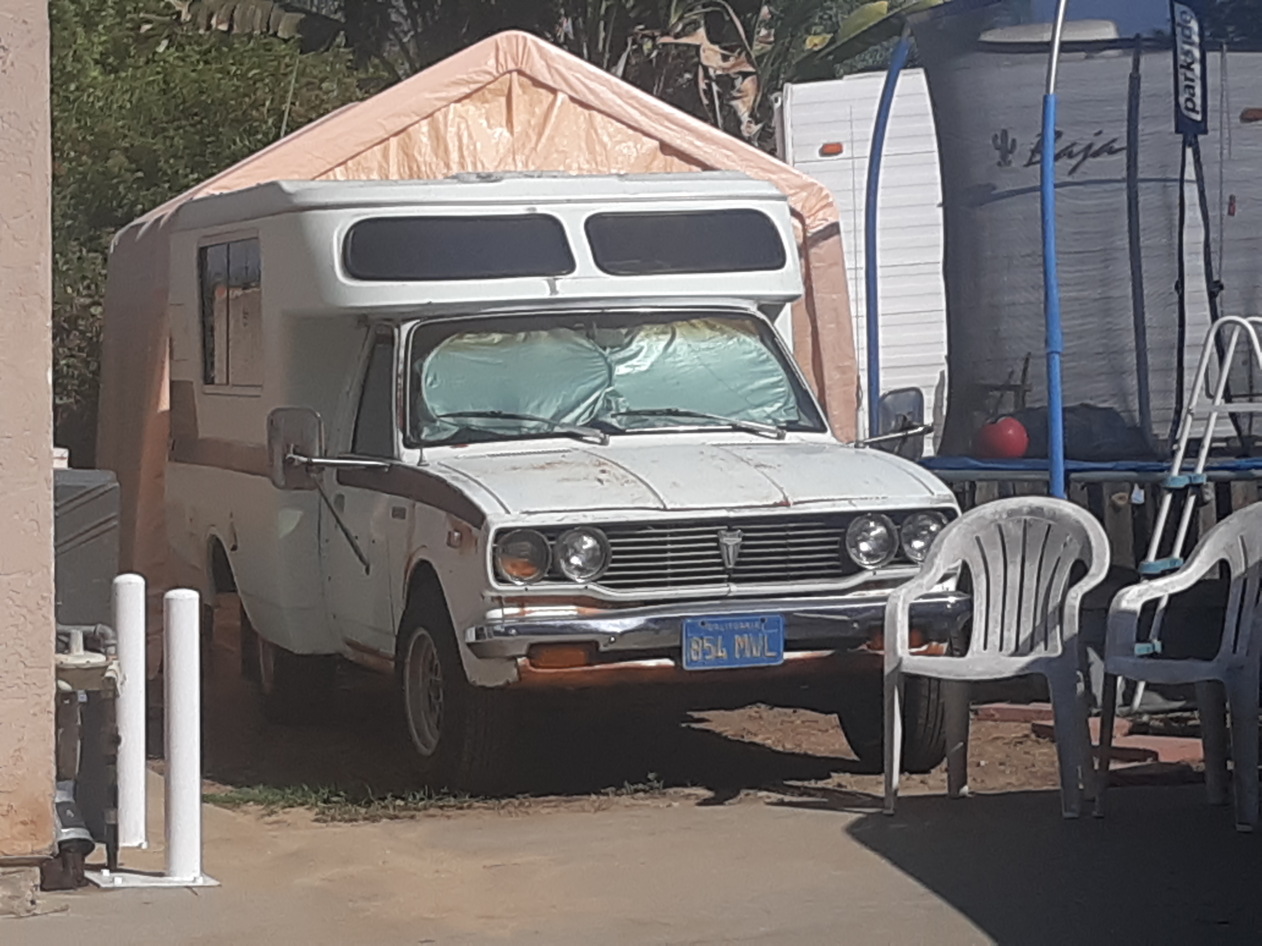

Check this thing out! It's right down the street from my new place...
looks like a '75, good potential there. Glad to see it on the OG cab, makes me mad when people transplant them.
The funny thing about chinooks is once you know somebody that has one, you will start to see them everywhere. Before that most people would never even notice it.
Will Smith Hancock movie has one in the background down the street. Right side of the pic.
