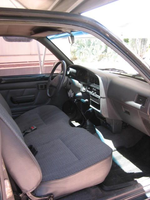

Here is the clean stock interior:

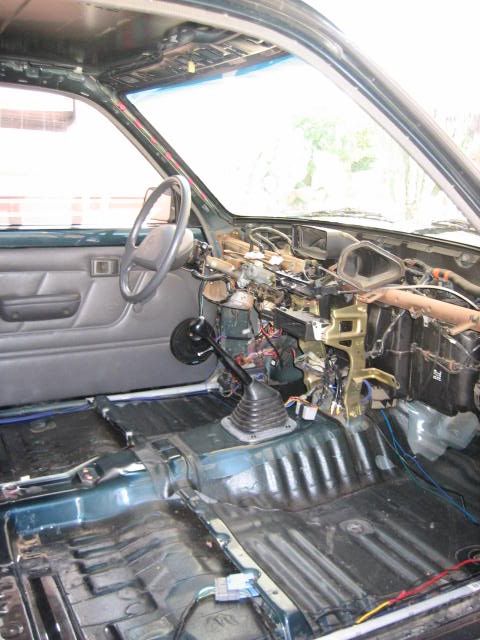

Stripped:

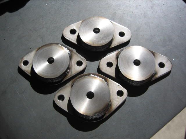

Solid Body Mounts:

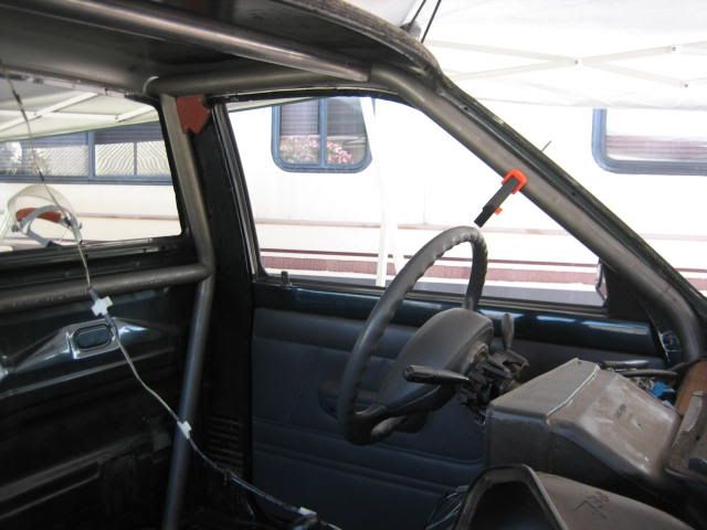

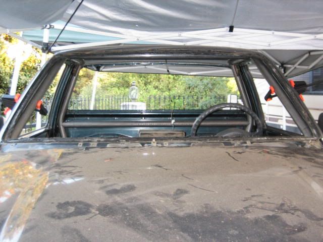

Cage work:

looks nice so far, but i could give you a little advice.....id deffinetly re-make that top/front cross tube.......put a bend or 2 in it and get it up closer to the windshield opening......not only will it look WAY nicer and more finished but it will give you a ton more head room.
