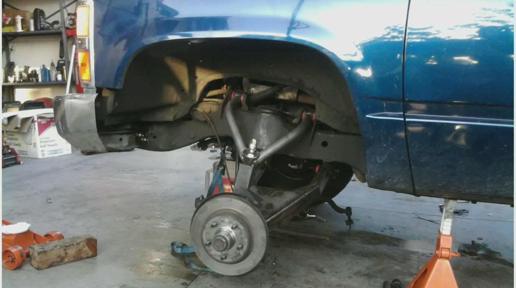

This is more of an entry level kit since it uses stock or lift spindles.
4.5" over ea. side, 1" upper and lower uniballs w/ machined tapered slugs so you don't have to drill out the spindles.
Kit cycled 15.5" before the lower arm contacted the coil bucket, has a little more angle in the upper uniball.
bump:
droop:

This is sweet! The coilbucket would be awesome! Easy to install and and Im guessing pretty cheap price wise! Looks good!
