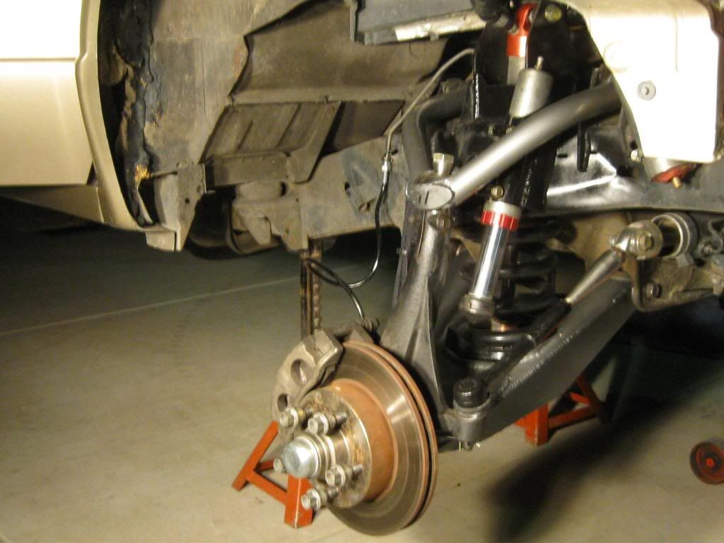

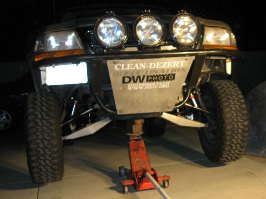

this is the new prototype midtravel kit we just finished. only1mikey was the guinea pig for this one.
3" over ea. side, right about 12.5" travel metal to metal, uniball upper, boxed lower with balljoints and will use stock or lift spindles.
Kit includes uppers, lowers, coilspring, tierod extensions, and extended brakelines.
full bump:
full droop, strapped:

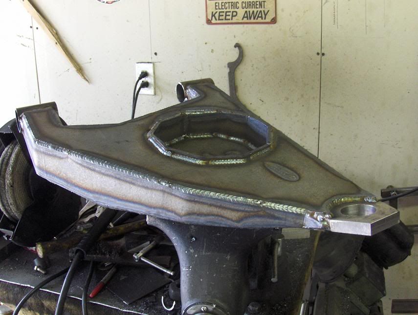

the kit:
lower arm:
