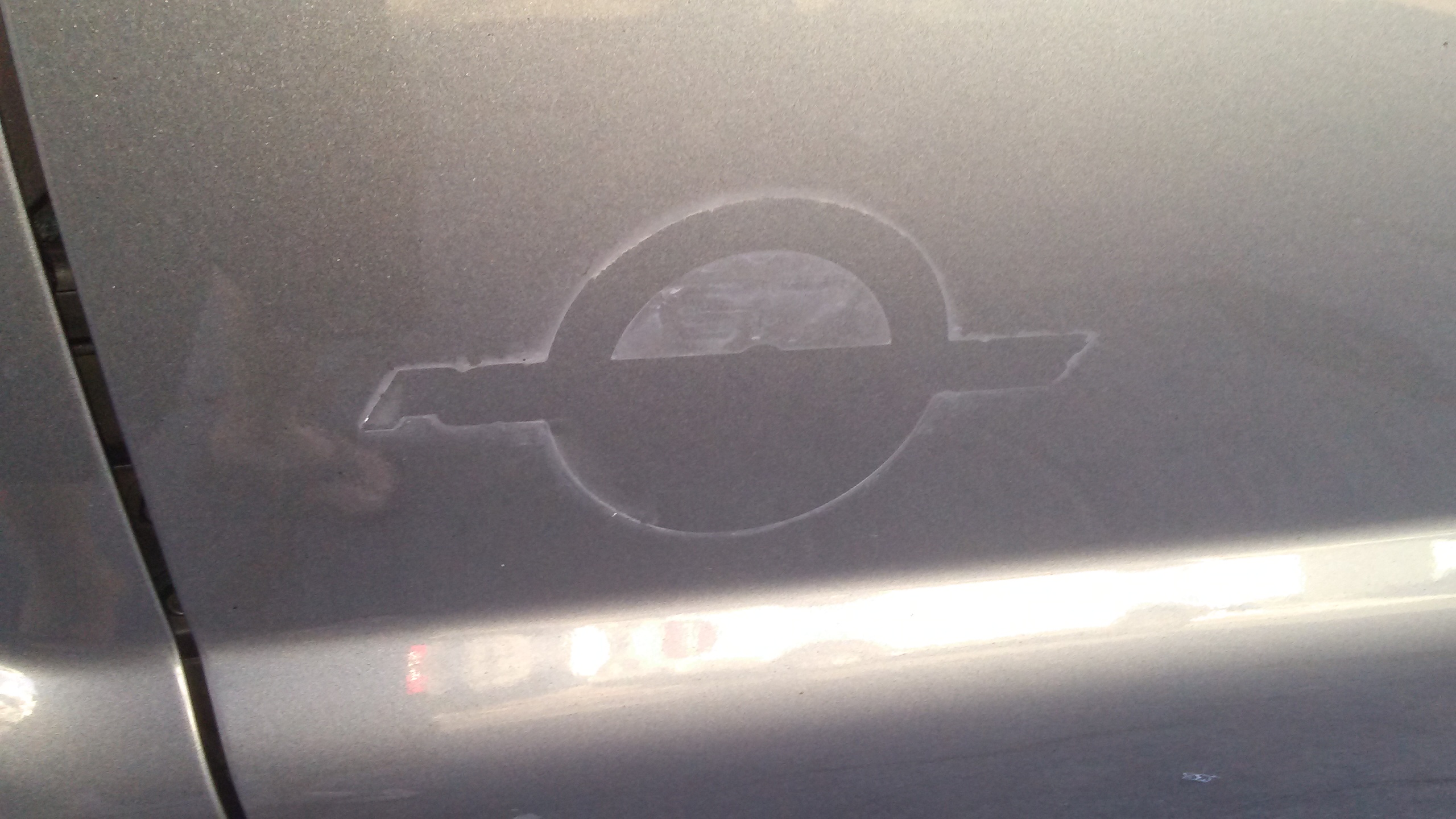

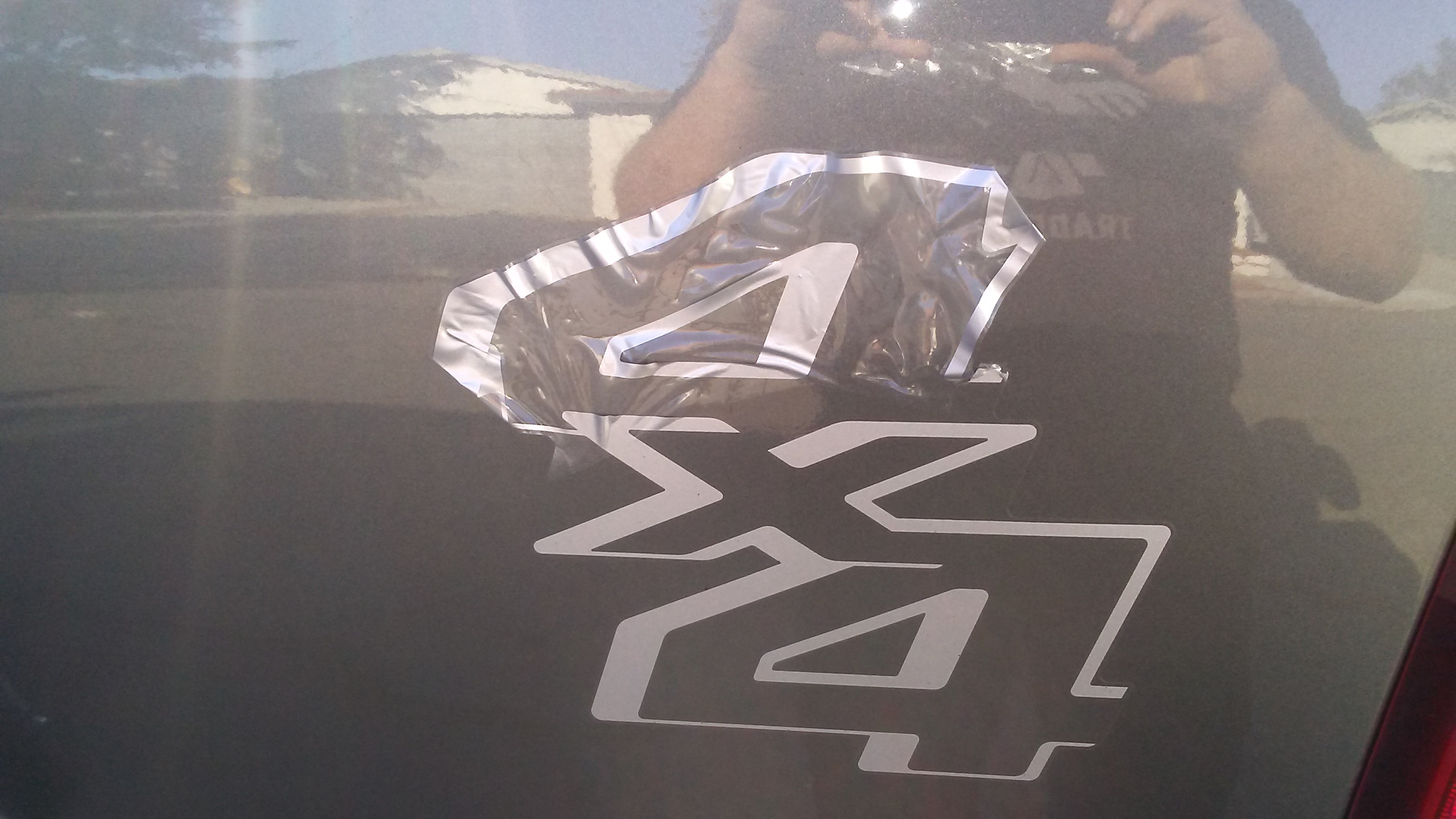

First step was I had to remove all the gay decals.

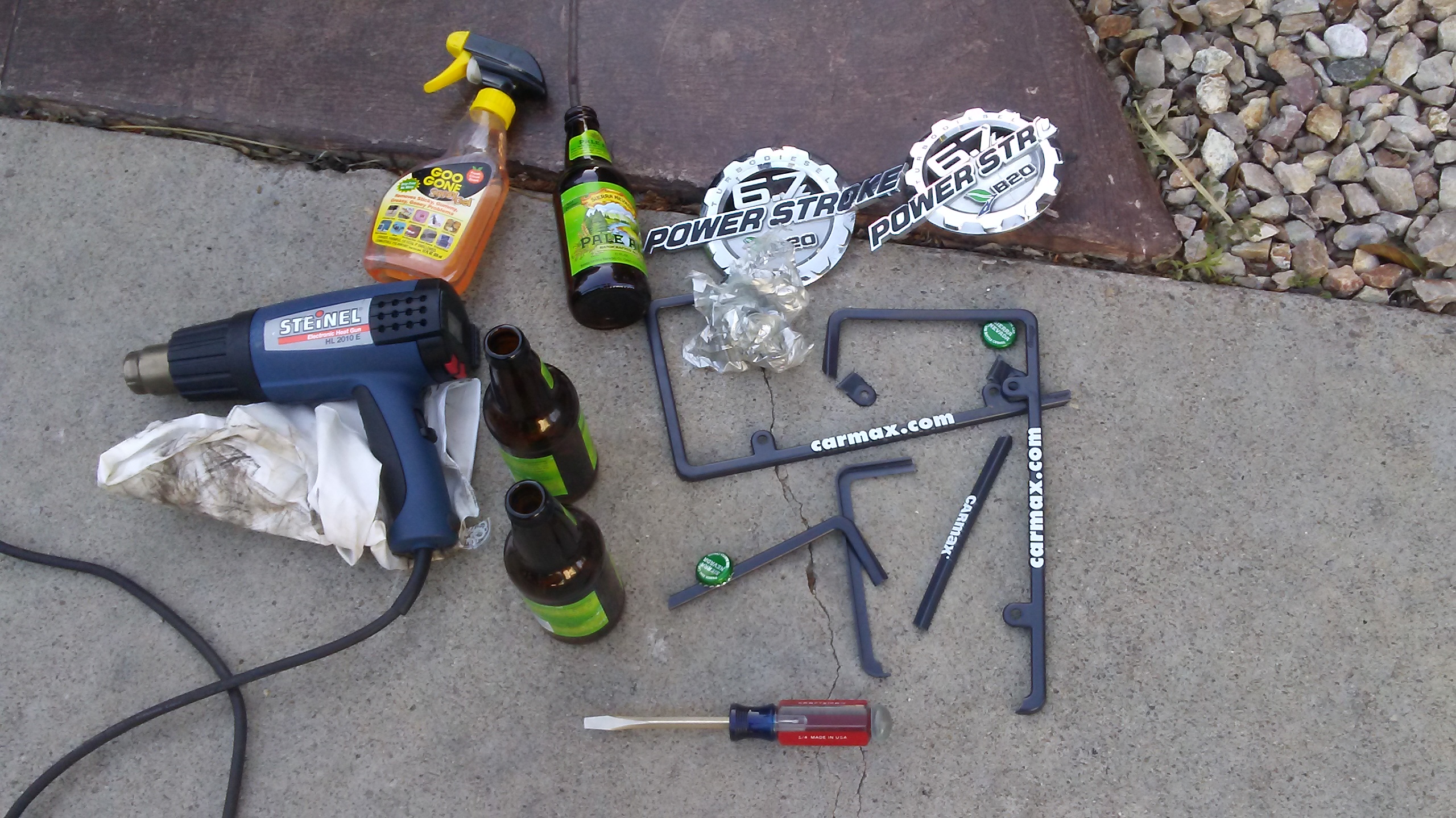

That's right babay. It's a power stroke. Soak it in. lol
