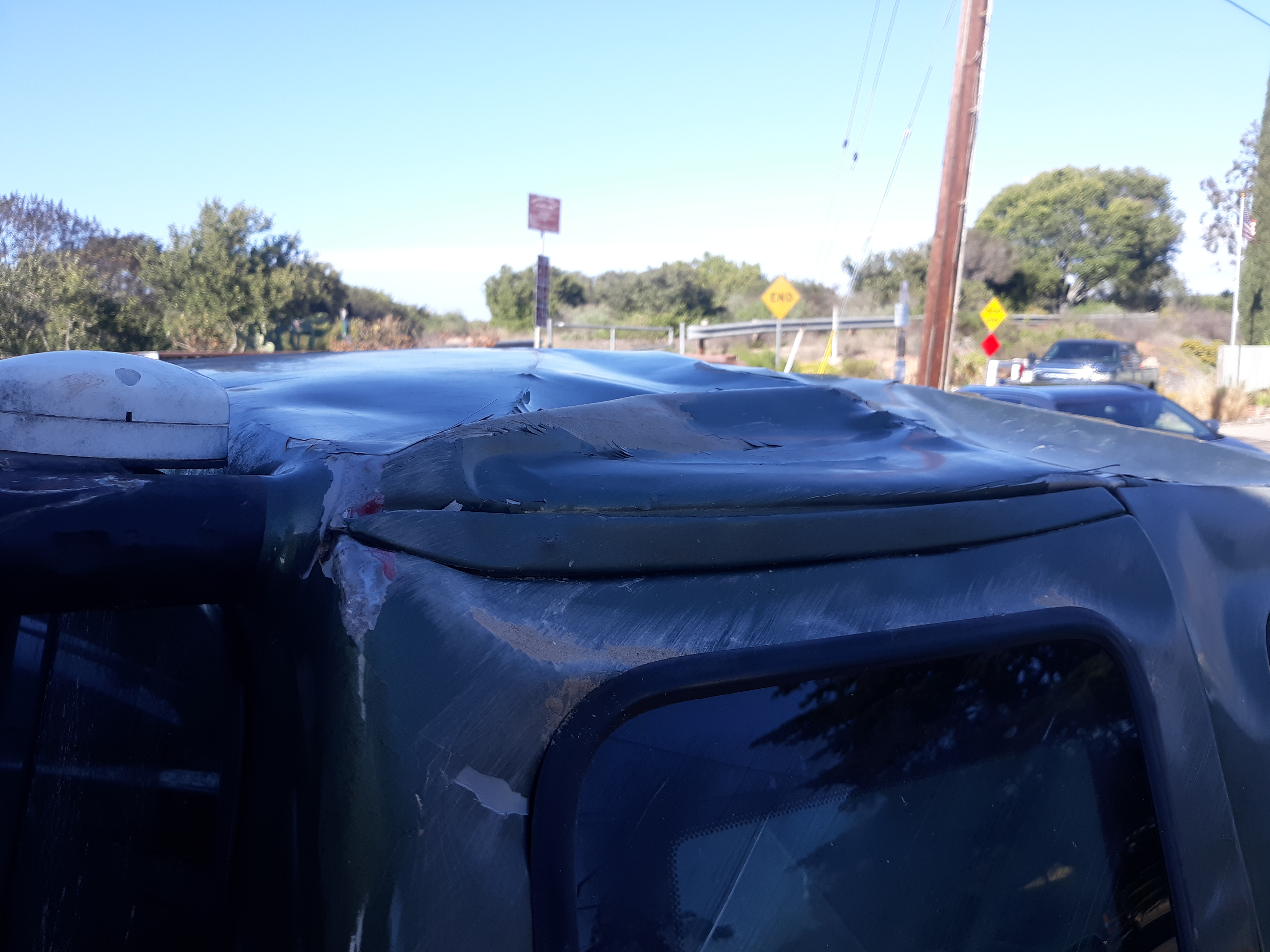

Roof looks like a bag of BRO-tato chips too.

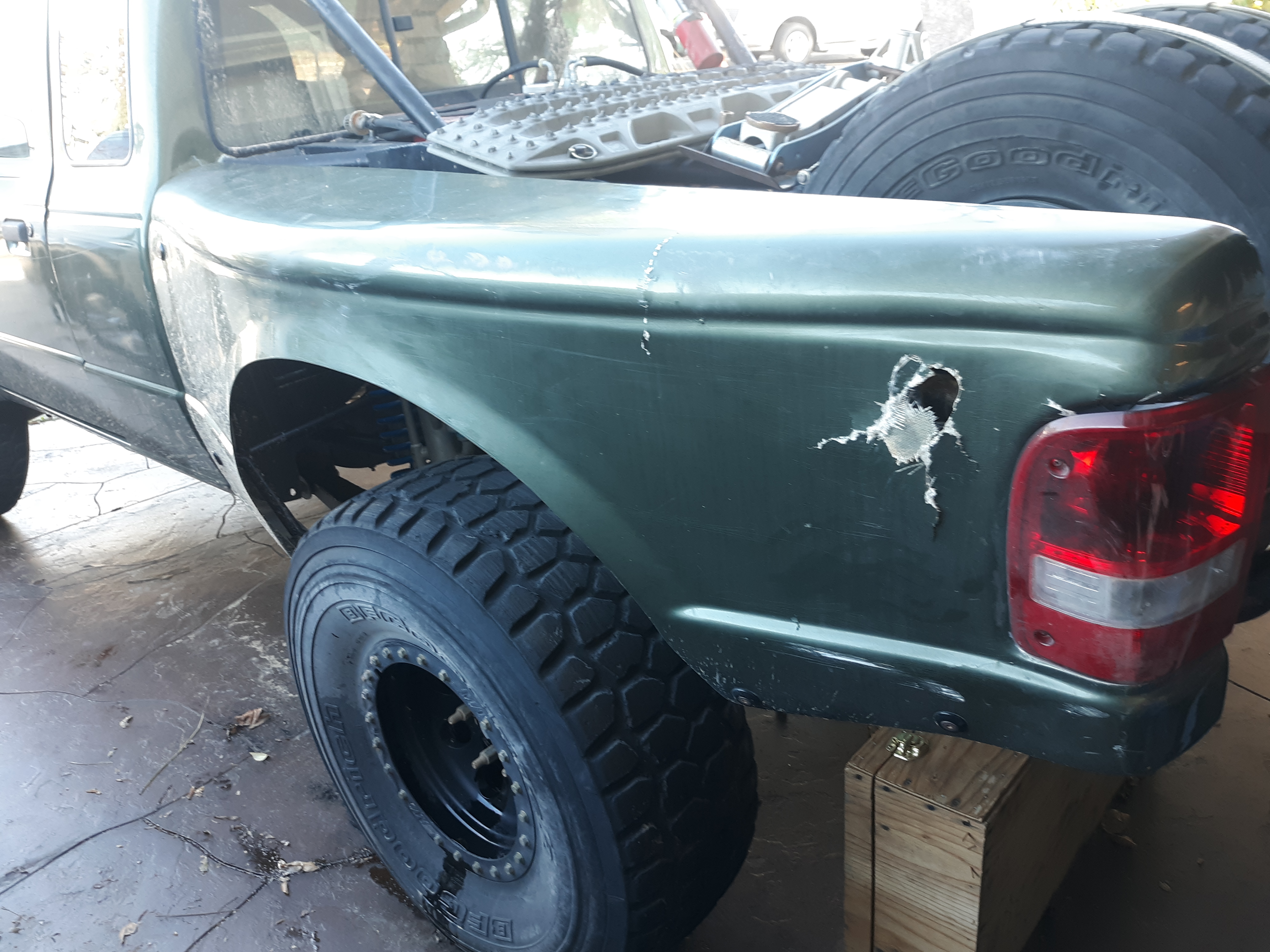

All the main portions of bedside mounts appear to be fine. Just a few bent tabs. But, the FiBROglass.... yea, not looking so good.

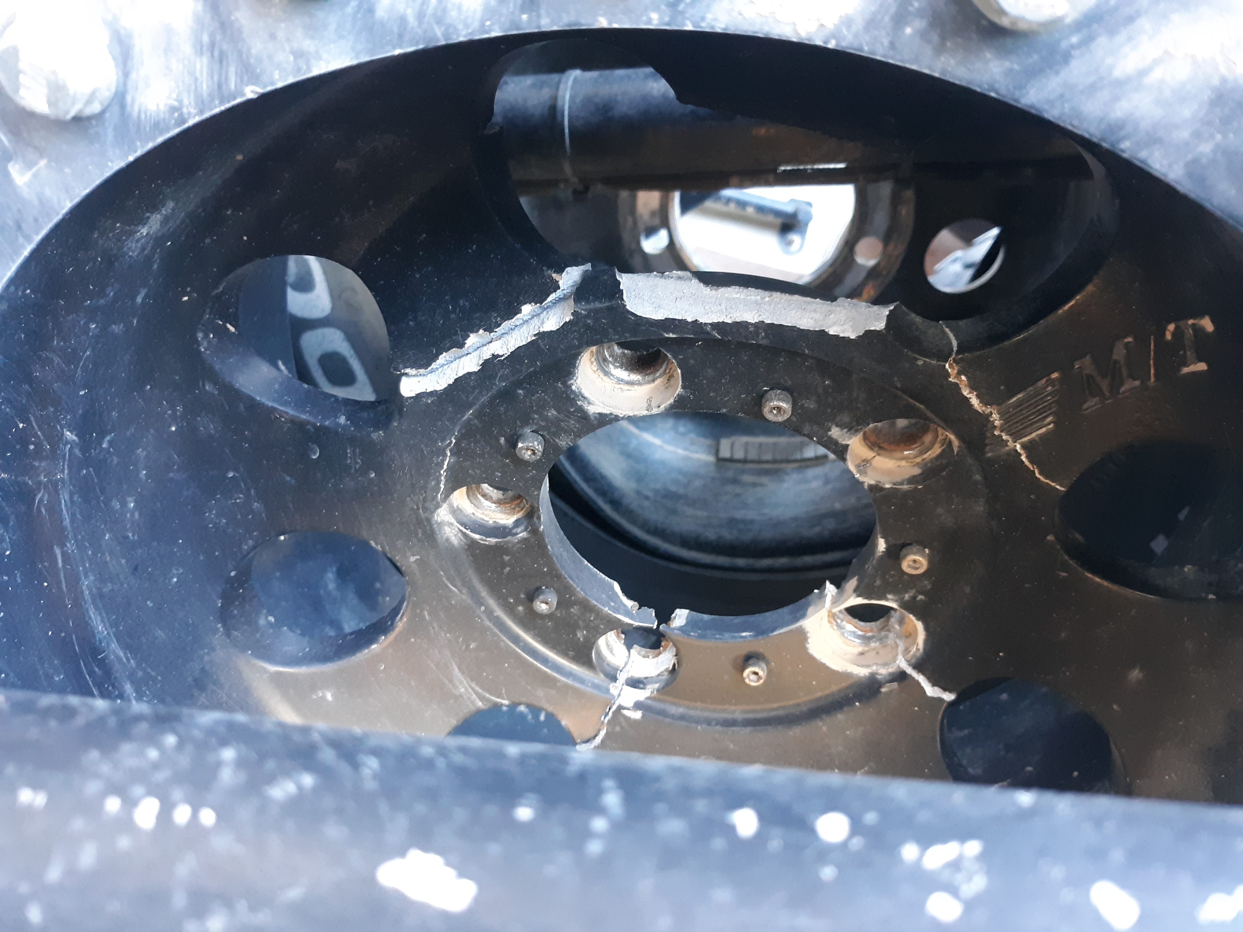

Mickey Thompson would be proud.... But, daddy need wheel
Make that a double!

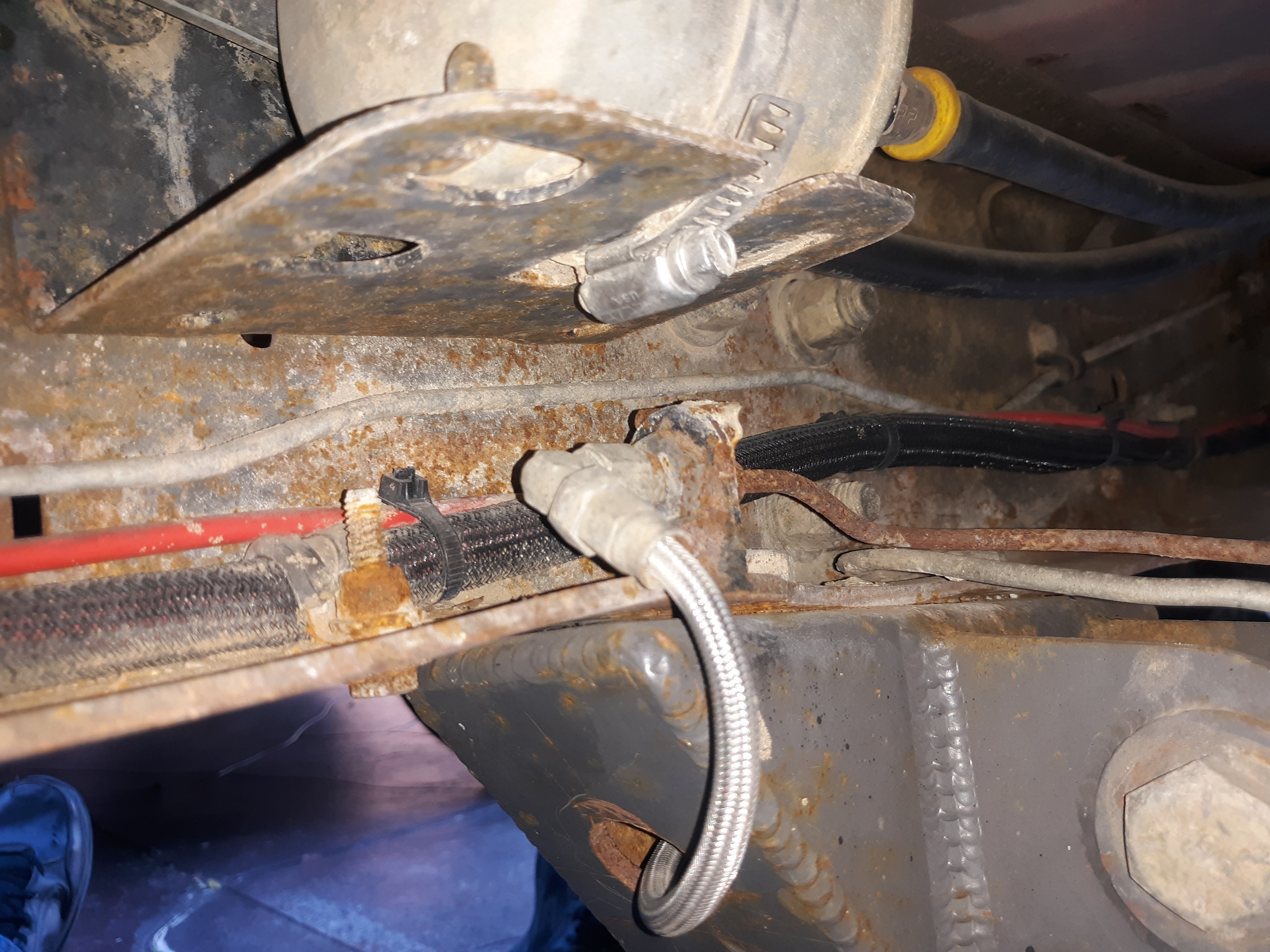

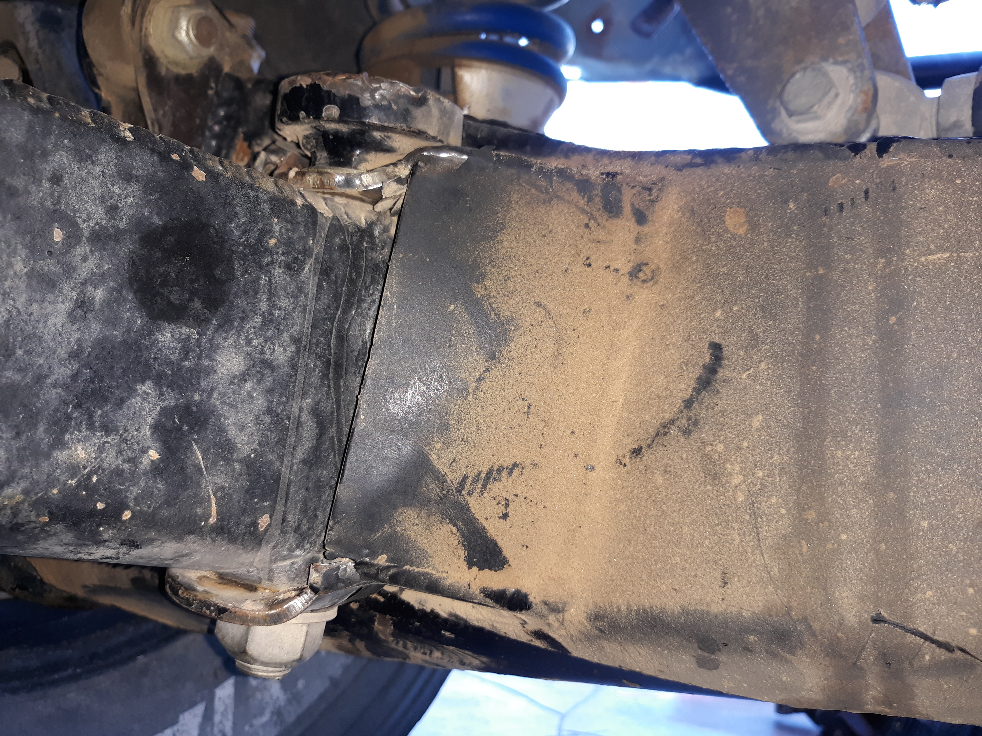

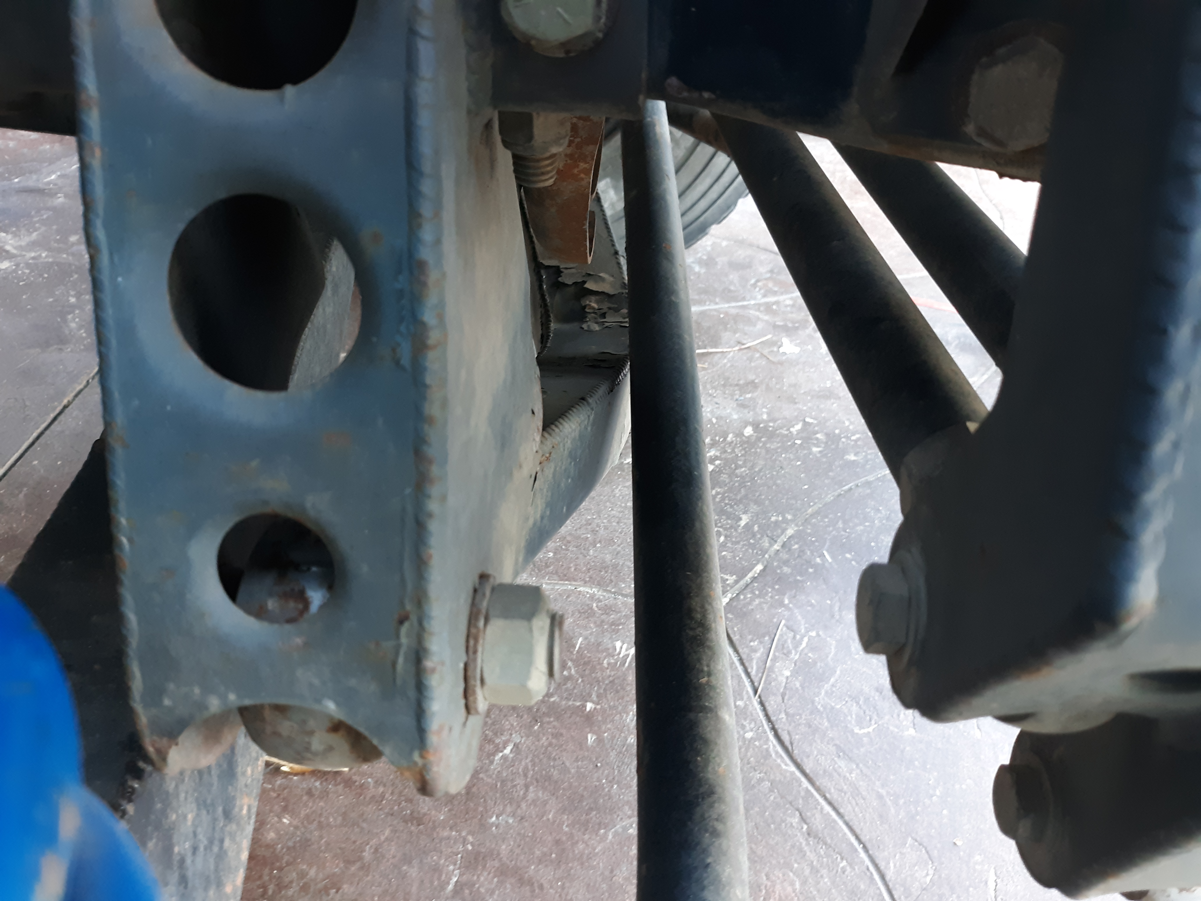

When the beam bent back... the bumpstop pad actually mangled the bracket for pass beam. We might be able to just beat this one straight. We hope.
You can see what it did to this side too. Hard to tell if brackets are bent in regards to pivot point. Hopefully things cycle OK and we can just beat it straight too.
Radius arm mounts seemed to move a little. Frame got a little twist. But should be fairly easy to fix.
My thought/hunch. I feel like the bolt in cross member allows shit to twist a little. See previous evidence on pass side too

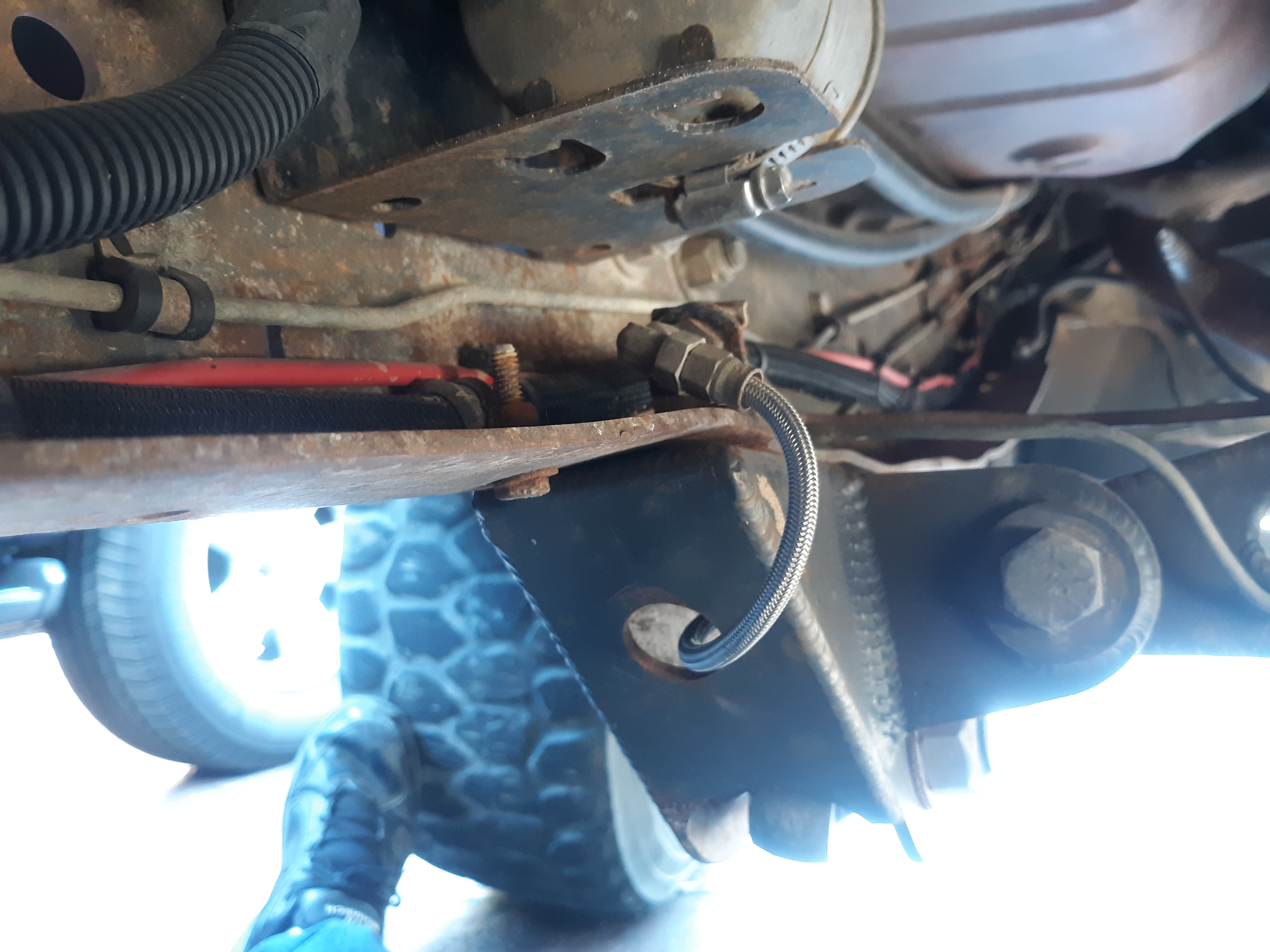

The lower bypass mounts are tweaked a little. I blame all that cheap ass hot BROlled steel I use.
Well, shit, it is on pass side too. So maybe this is from BROver jumping everything in sight over the years. Probably will straighten and box these on pass beam... maybe even put an overlay to thicken it up.

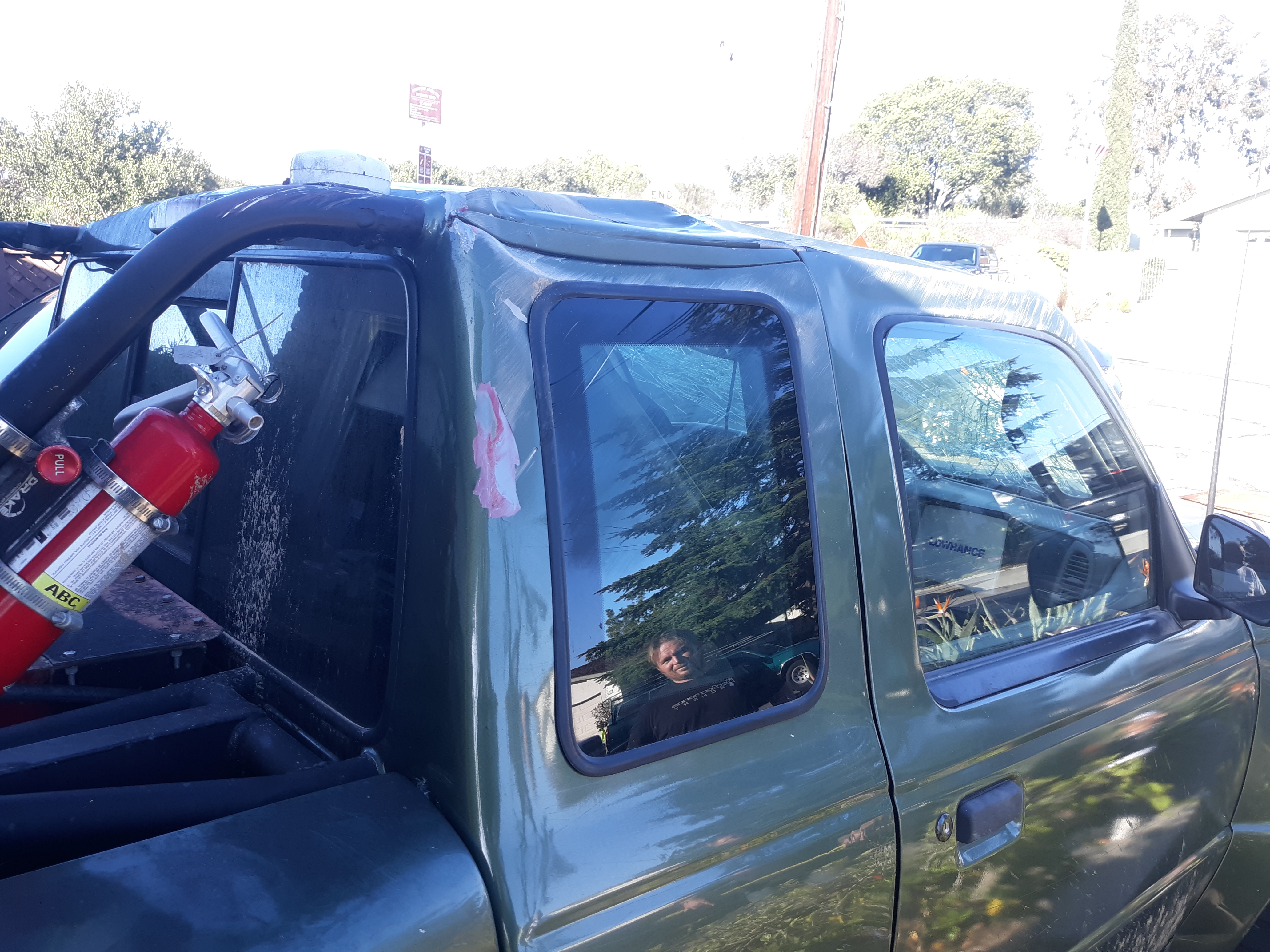

This piece of fiBROglass somehow made it through virtually untouched.
Mirror and glass on both sides good too. WTF! That's a first.
This door seems perfect too...

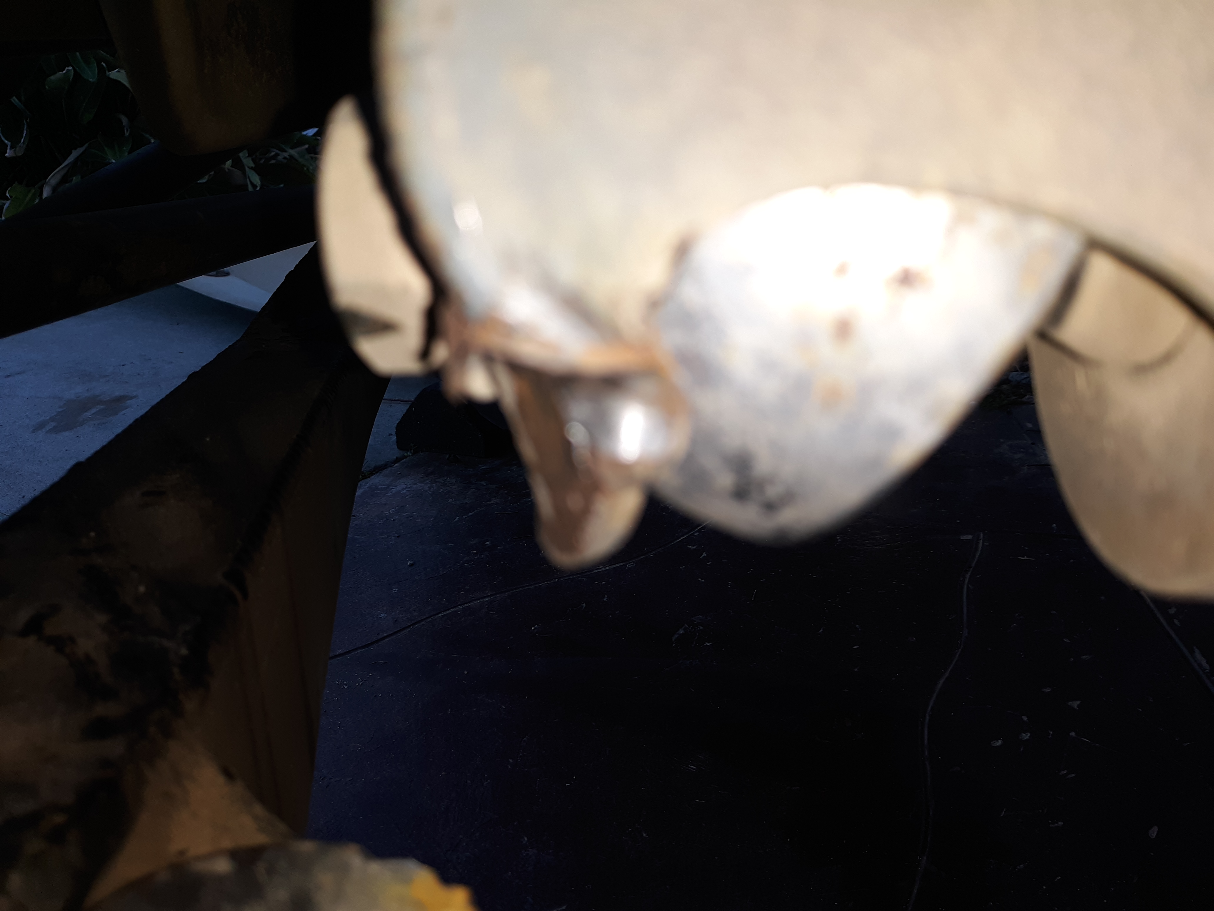

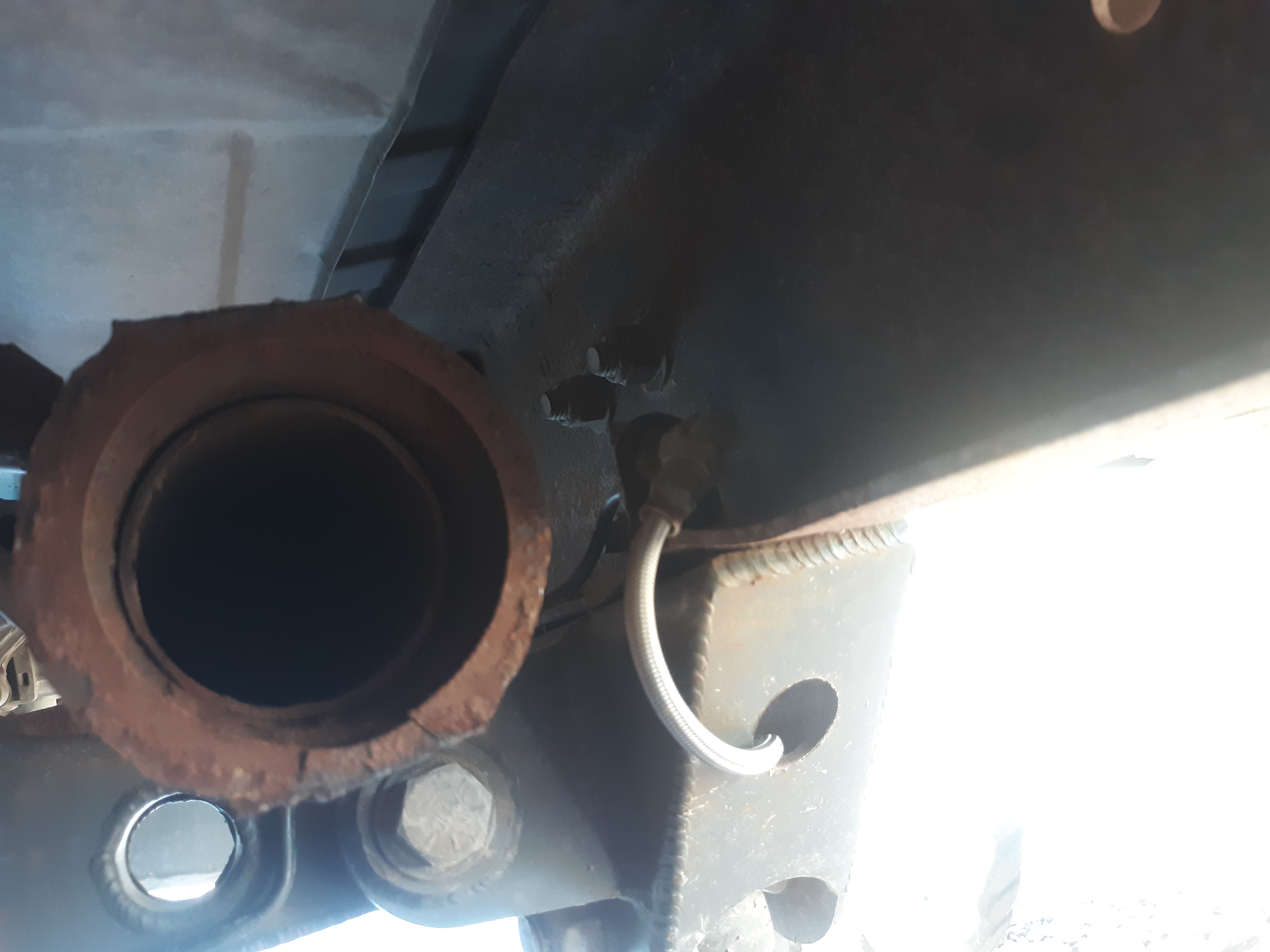

The front fender/hood mount is... fully BROasted. Looks like shock ressy end cap area might have kissed tube too...hope it's not bent
So is the box that held PDU
It appears to have put a little bit of a depression in the main chassis tube. I think it should still be OK though. What you think?
Hard to believe.. but so far, only that is the only section of tube that we have had to cut off.
