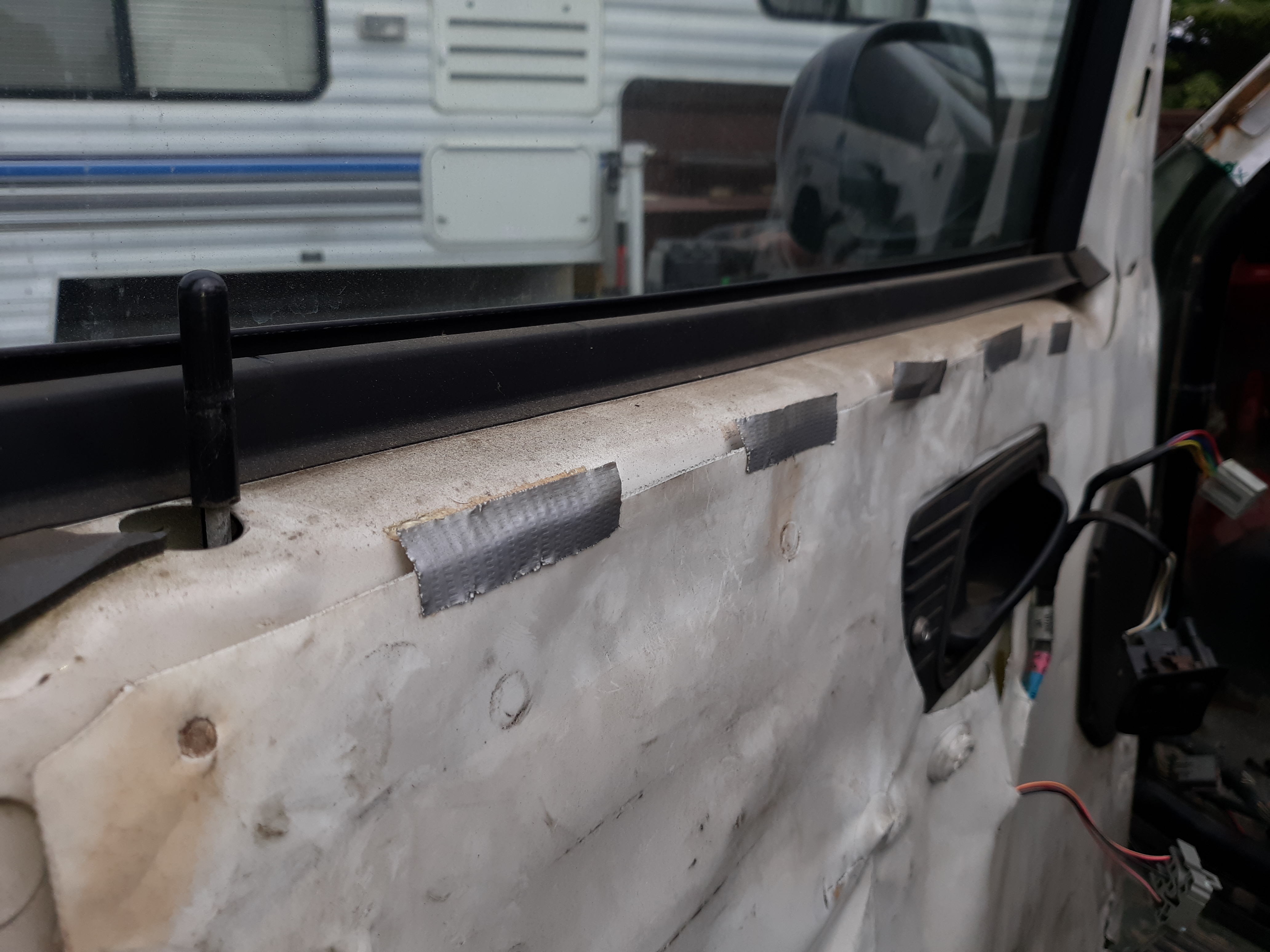

Hung doors.
Driver door...
Someone did some sick ass duct tape repair work before us. LOL

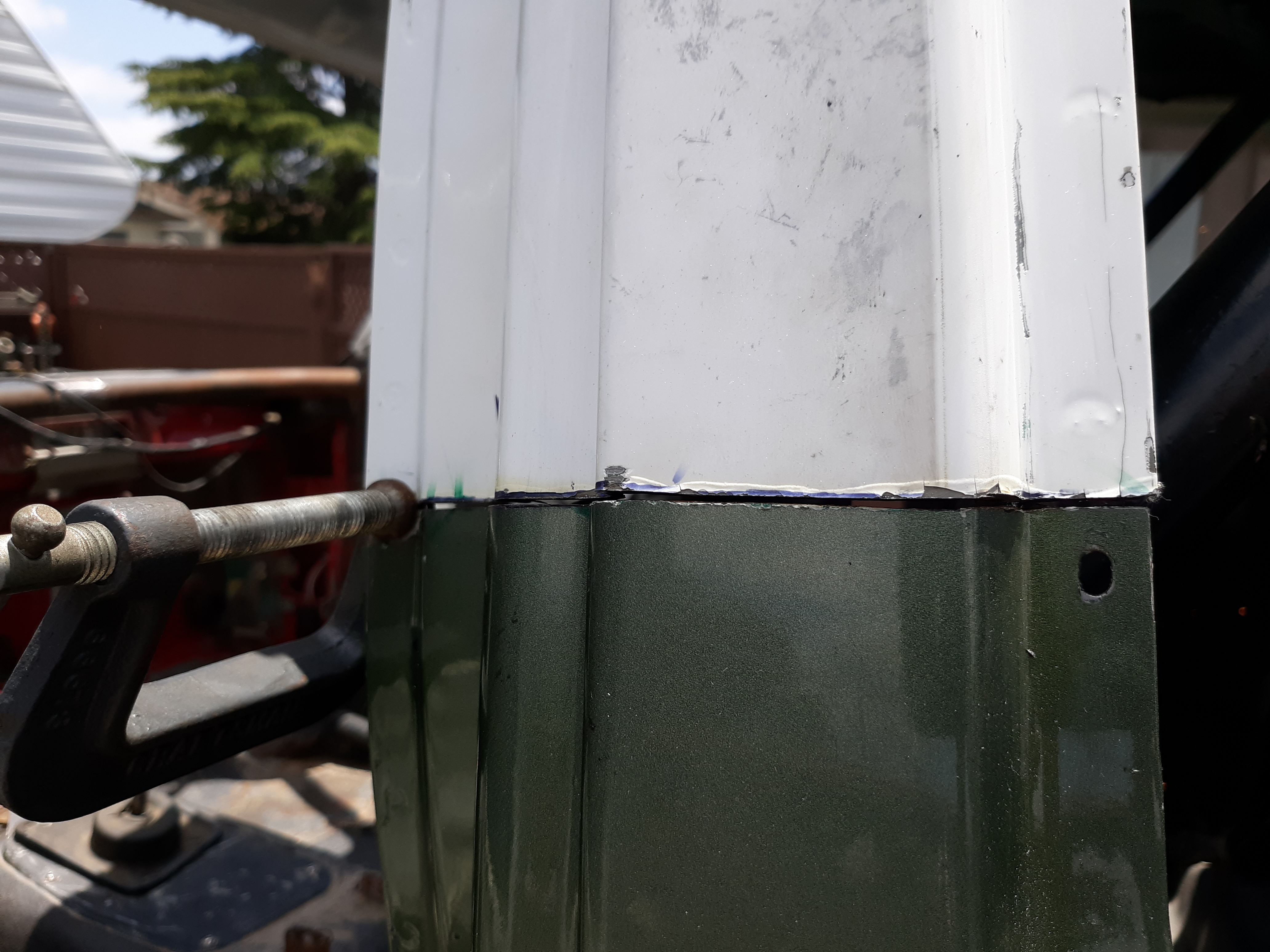

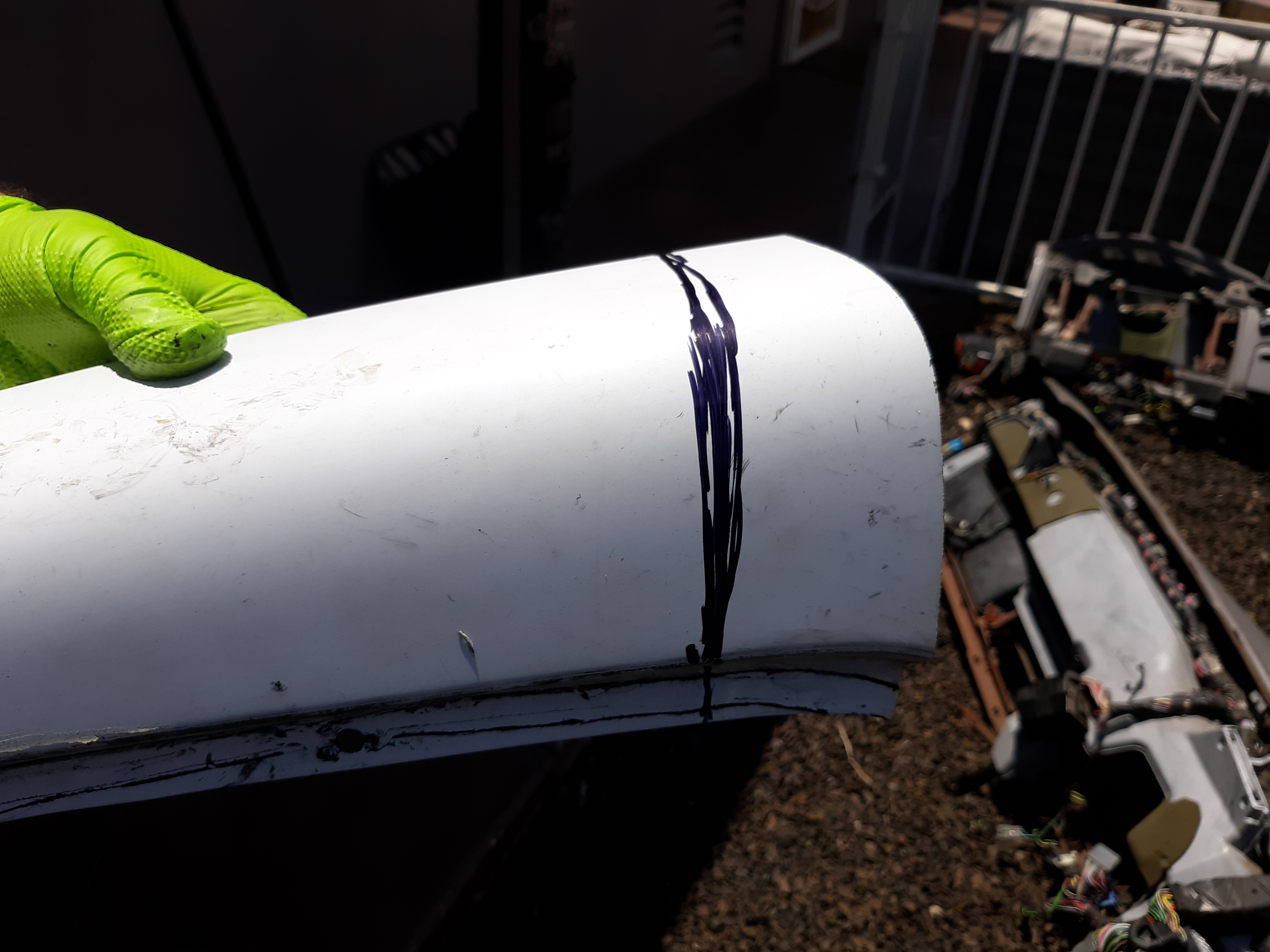

Then it was time to trim B-pillars fully in place... What happened here Justin?? I said don't cut too much. "hey man, that was my first cut... i got way better as I went on!"
I guess he was right, because this one looks great after some massaging... like perfect.

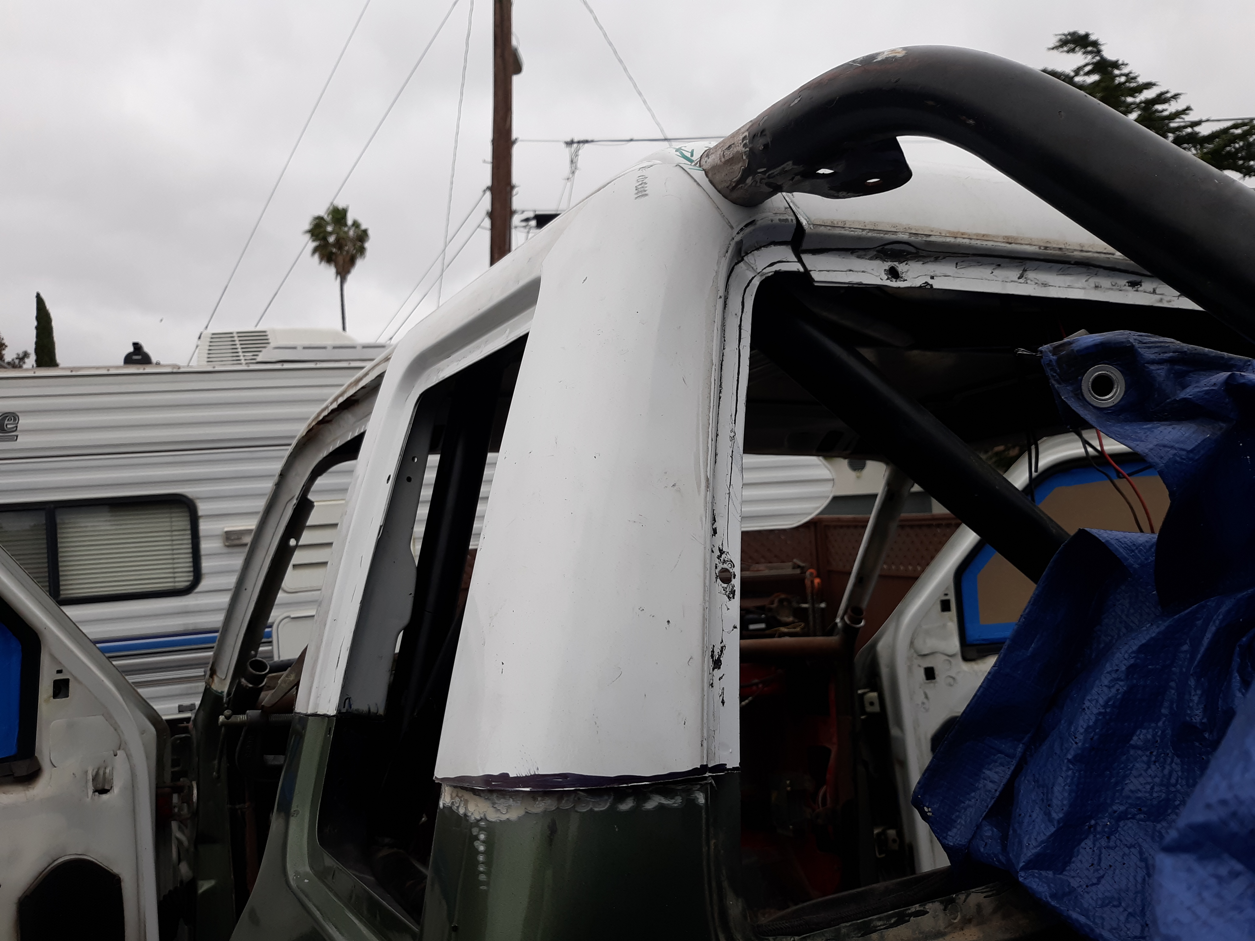

And then started on the c-pillars.... took it slower on the first one.

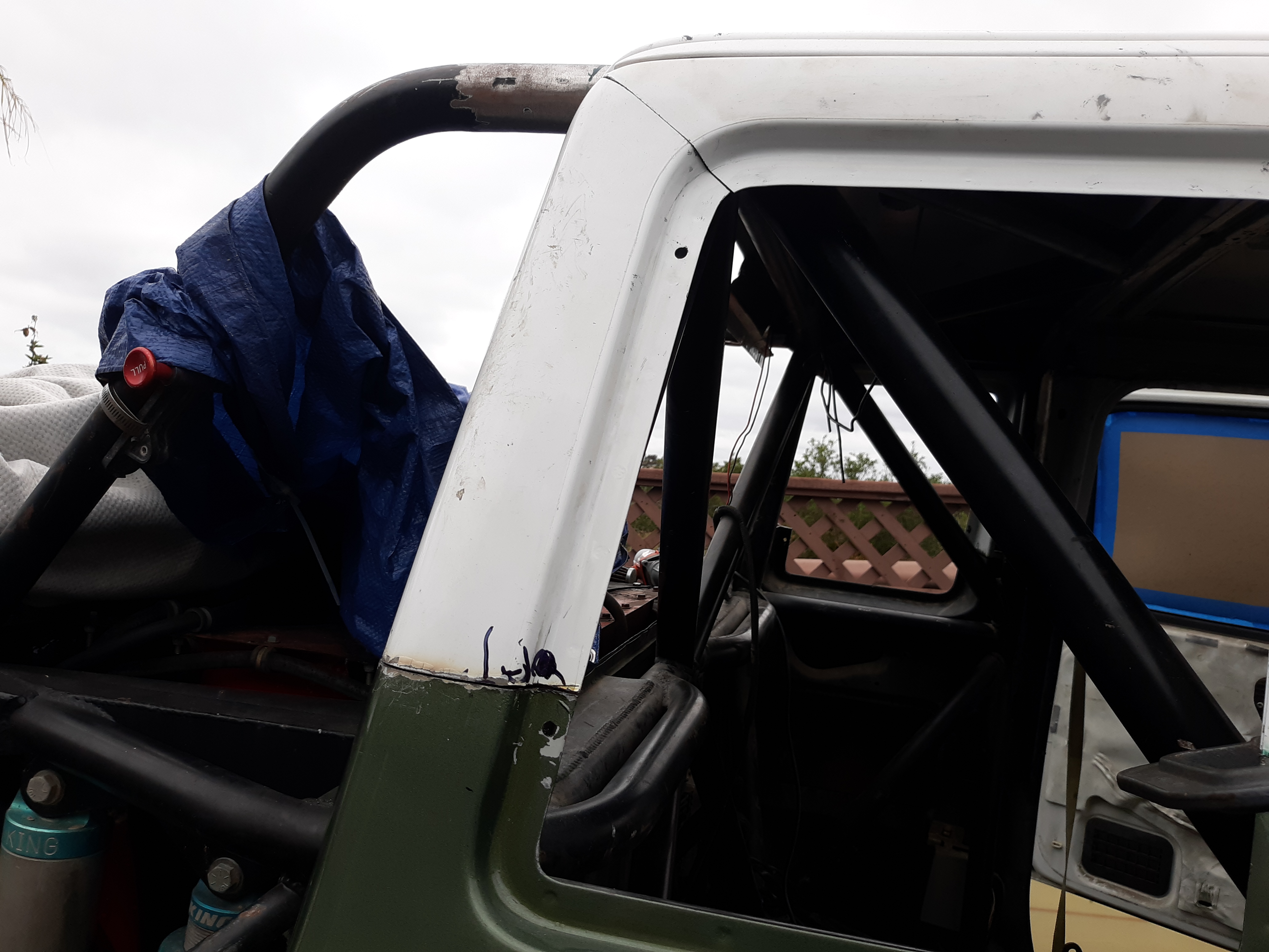

And then we got more aggressive on the driver side. Me: "Here cut on this line" ? Him: Uhhh WTF. Where??? hahaha.
Well son of a bitch... fucking nailed it (this was the first cut on d-side!)
And tuned that bitch in

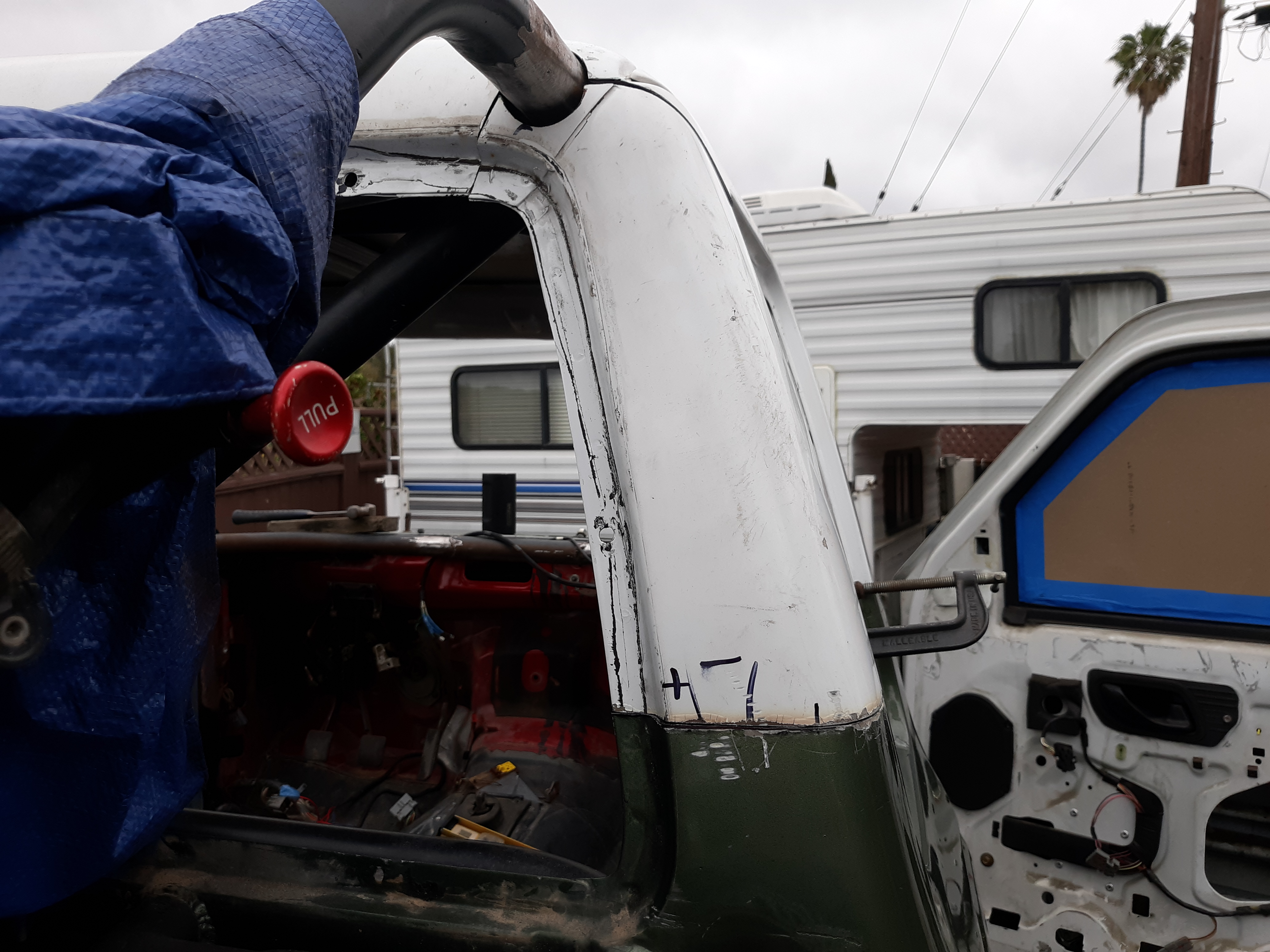

Windows all seem good so far...
insides good for most part too.
Except that god damn first cut ya BROZO!
