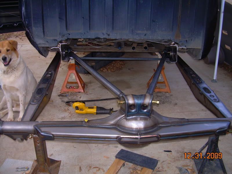

so ive decided to waste more time and put my project pictures here. they are also on RDC.
i totalled it in august, fixed it for $900 to make it my DD again, then parked it, got a '90 Nissan Hardbody ext. cab.
pics for everyone
now for the other car that hit me. (Eclipse)
now for the build
SPECS:
wheelbase: 140"
front track: 91"
rear track: 89"
rear travel: 28-30"
front travel" 22-24"
drivetrain: SBC 350 & TH475 (beefed up 400)
GIANT WIY trailing arms & brackets
THREAT beams, radious arms, and radious brackets.
Trailer products fiberglass
Walker evans Beadlocks 15x8- 5x5.5
goodyear yellow labels or BFG BAJAs
Beard super T1 seats
winter shifter
FOX 2.5x 16" coils all around
KING3.0x 18" rear 16" front bypasses
KING 2.5x 4" bumps
2 more
FlexJ
Feb 21, 2008
4,152

It just seems lazy to me that you would actually run the X in the back of the cab like that. Why cut corners with something that your life will depend on?

Not worried about the x being uncentered. I already fixed The one diagonal that matches which meets SCORE rules. It's my first build so there are little problems like that.

U need to fix the X in the cage man...looks like crap that way...everything else looks good...

if its your first build you need to take your time and plan everything out...."It's my first build so there are little problems like that. " I would make sure there are no problem....look around and see what other trucks cages look like...
