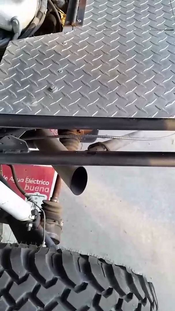

I pulled the stupid rear deck thing made of diamond plate because this isn't 1982. That piece of shit was cut out and bolted on with a pure and complete disdain for human hands/forearms. Also cut the cross bar that it was sitting on because it was a piece of shit as well. With all that shittiness out of the way, I pulled the VG30 out of there.
Close-up of the shit mounts made by the shit-fabber:
