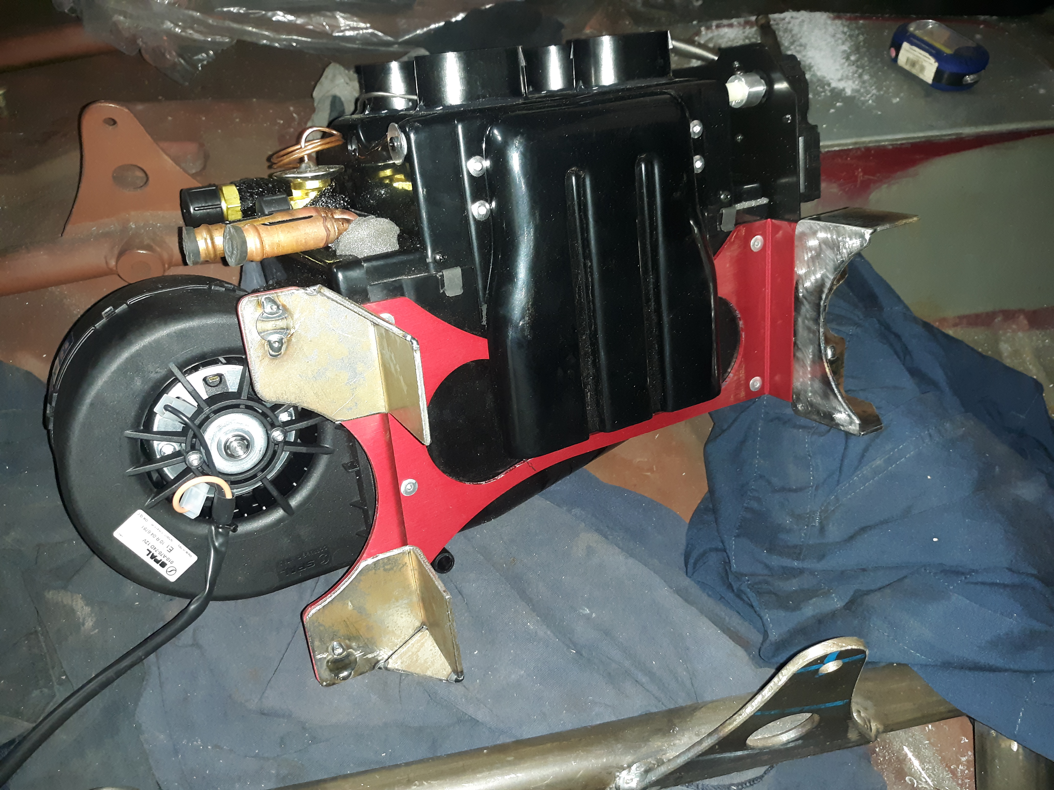

Tommy, No, I got the small "Bantam" one because I had no idea on space really, and based it off the flat firewall space. Now that I am spacing it off firewall anyway... I wonder how big I could have gone? I still hope to use that firewall space under dash to mount a bunch of electronics though, like SwitchPro modules, AC controller, Holley ECU, etc. Shit, probably not enough space. And this thing probably won't be enough AC either. Win, Lose? haha

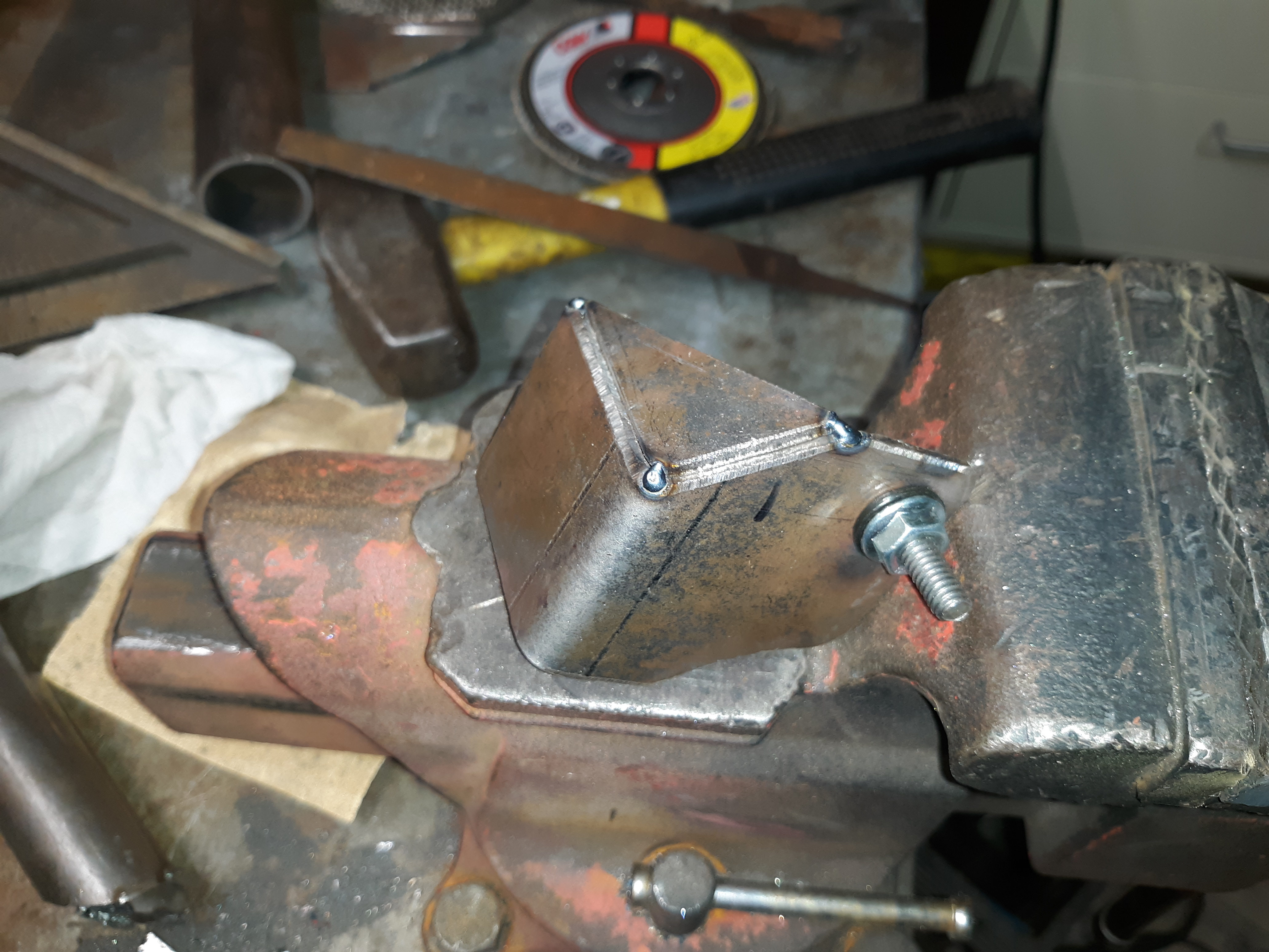

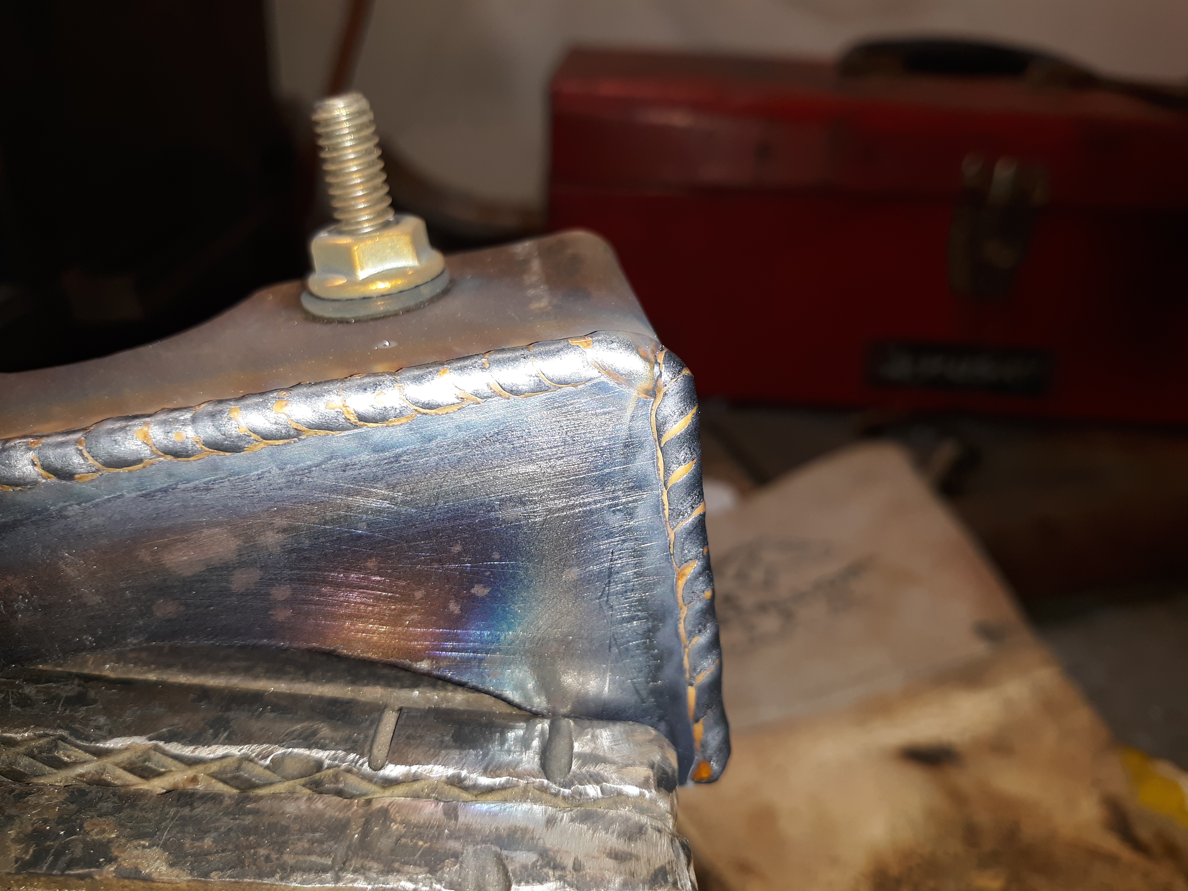

And the other side mounts getting done... just gotta weld and blend them
So, yea... almost ready to glue this thing to firewall now!

Main Restomod unit mounted. The current plan is to mount the defrost vents to the truck(between dash tube and body right in front of the sill the dash mounts are on)... they will be way down at bottom of window.... and a bit closer to window than factory mounts... but won't be stuck to dash... and I assume will still work.
Sticks out the bottom a bit... but factory one does too if i recall correctly
