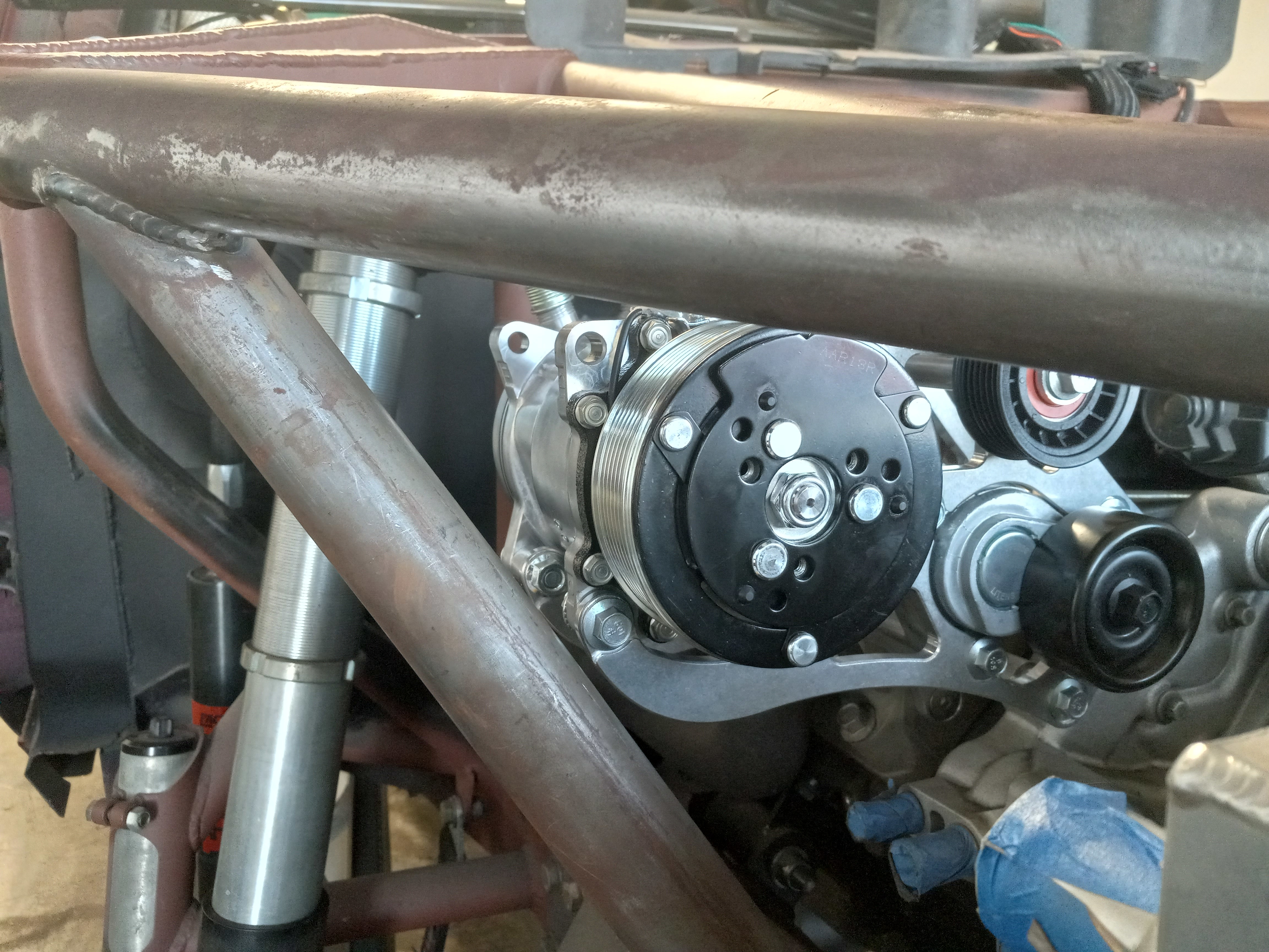

put all ICT stuff on for mockup. Need to take shocks apart soon to figure out what I need to convert.
Yould think I put that tube in after the AC from the looks of it. LOL
Got the caps done on top. Didnt break justin's vice. His is sturdy like german girl.

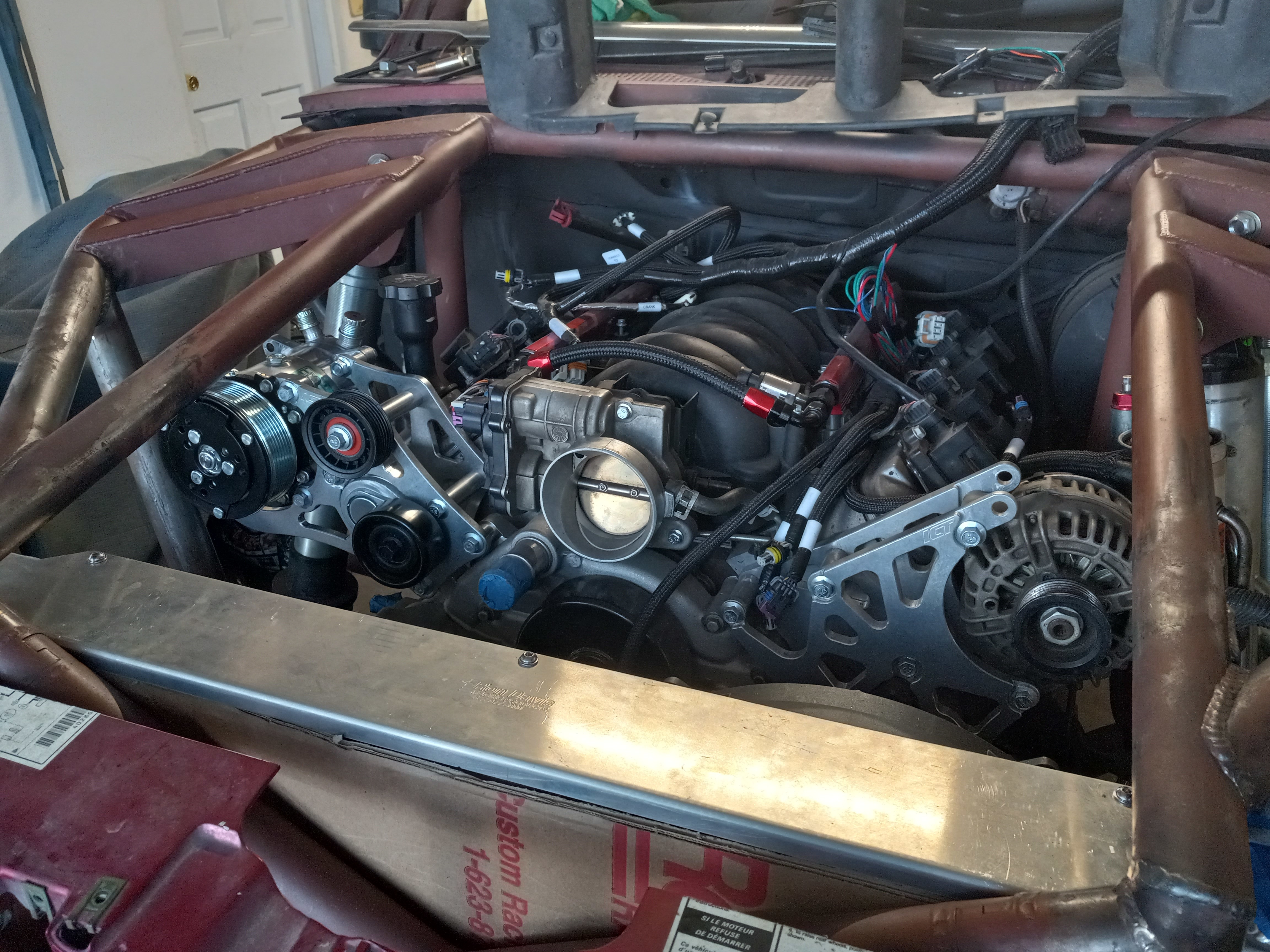

Went with that OG radiator mount design because it was ok looking and I needed to move on....
put some rubber in there on top and bottom.
Have to wedge a punch or screwdriver between tube and mount to push them down enough to get bolts in/out.
welded up all the mounts after some test fitting
I think all the pressure makes it look bowed down a tad?? It ended up super tight and sturdy though. And I like that.

I like the radiator mount tabs. Simple and effective. Often times I overthink the design trying to make something super fancy and the simple idea ends up looking best.
