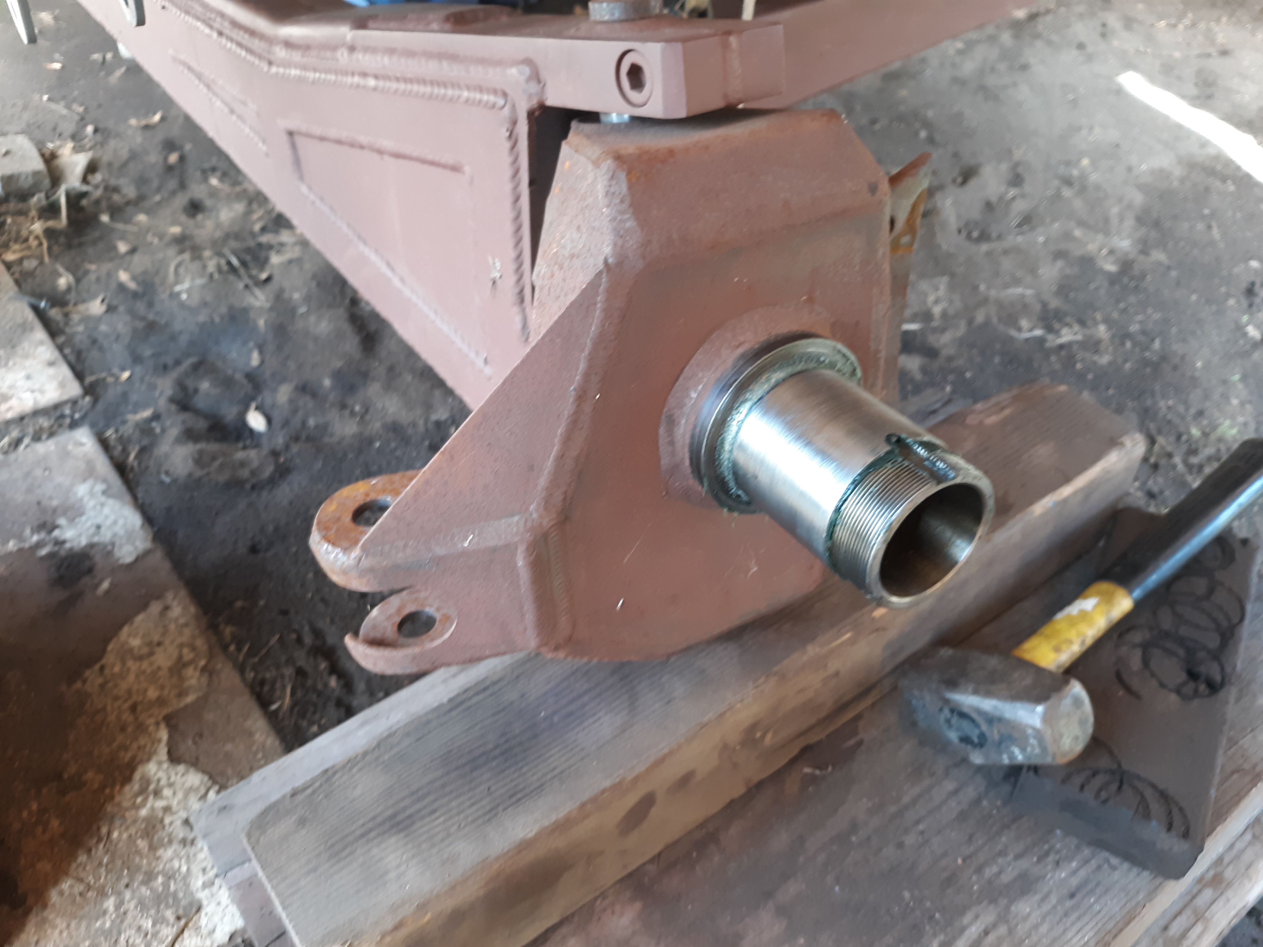

Heard Black Friday was in town... So that means I had to paint my knucks, bro! I may or may not have gotten my ass kicked by this black friday guy. Stay tuned for pictures of parts soon. Meanwhile, to get my knucks ready... I had to pull the sick gnar Camburg hubs off. Gotta say these hubs are pretty fucking nice. Bearings are huge. Snout and knucks are burly.
And holy shit. These things were on like a mother fucker. I had to beat the living shit outa that massive camburg tool to get it loose. And somehow i managed to break the star lock retaining ring... on both sides!! Hmmm, that could a been a big part of the difficulty. LOL. Not sure why they hung on though. I bent the tabs back. Maybe not quite far enough? Add 2x of those to the shopping list.

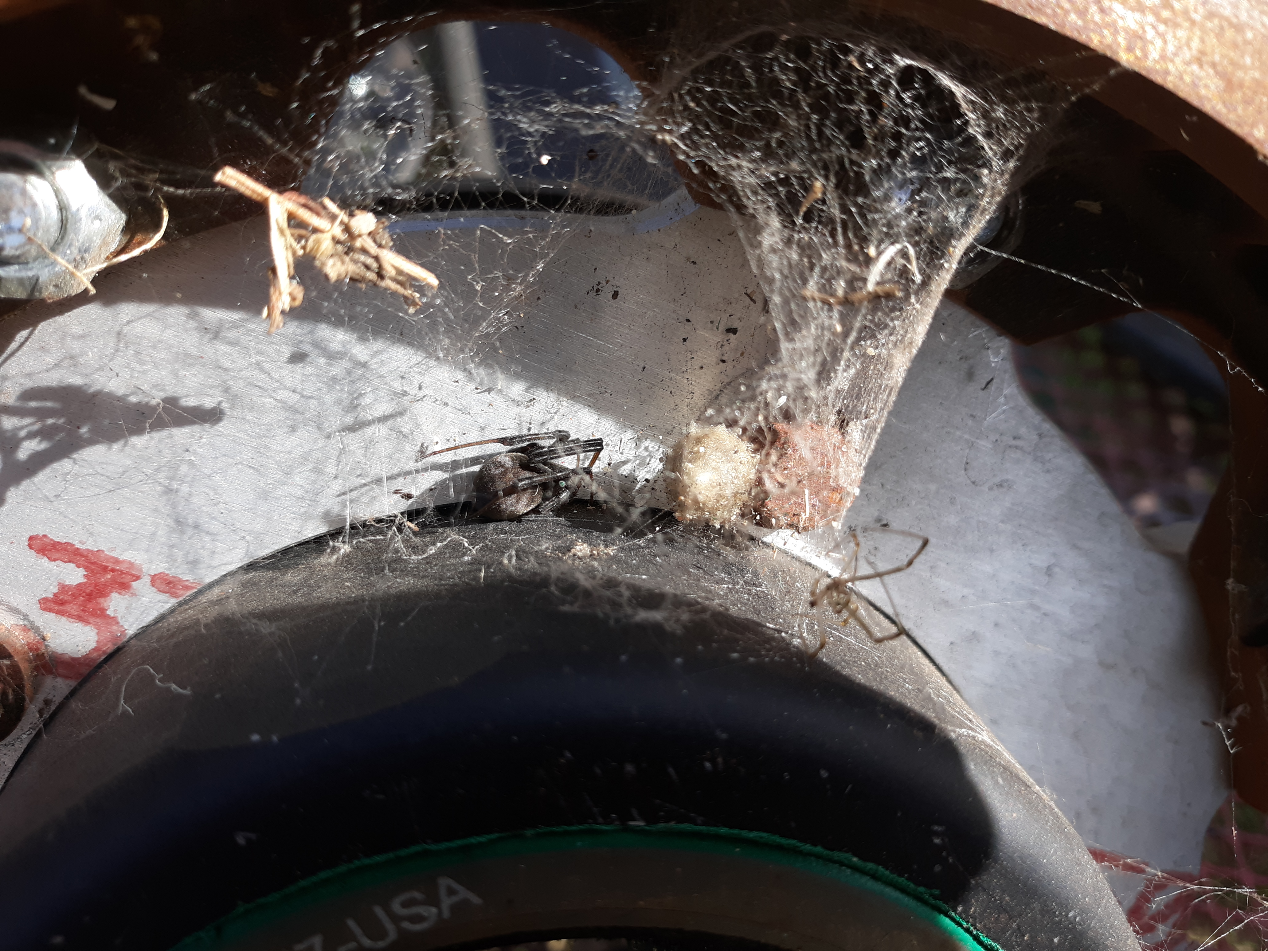

Then the fun continued. When I yanked the hub... I saw this bitch right by my fingers... was thinking she might try and bail out or attack or something like in the movies! So, I was more worried about her.. and dropped my fucking outer bearing in dirt!! Brilliant. Grease was all perfect too. Gay. Add some grease to the list too. (I may or may not have left the lid off my current grease... and blasted it with grinding sparks. LOL)
All that work just to get these prepped like this. Think I am gonna do the knucks in the hammered gray. Contrast the black beam. Or wait.. Maybe i should do them in Gold, NUKKA!

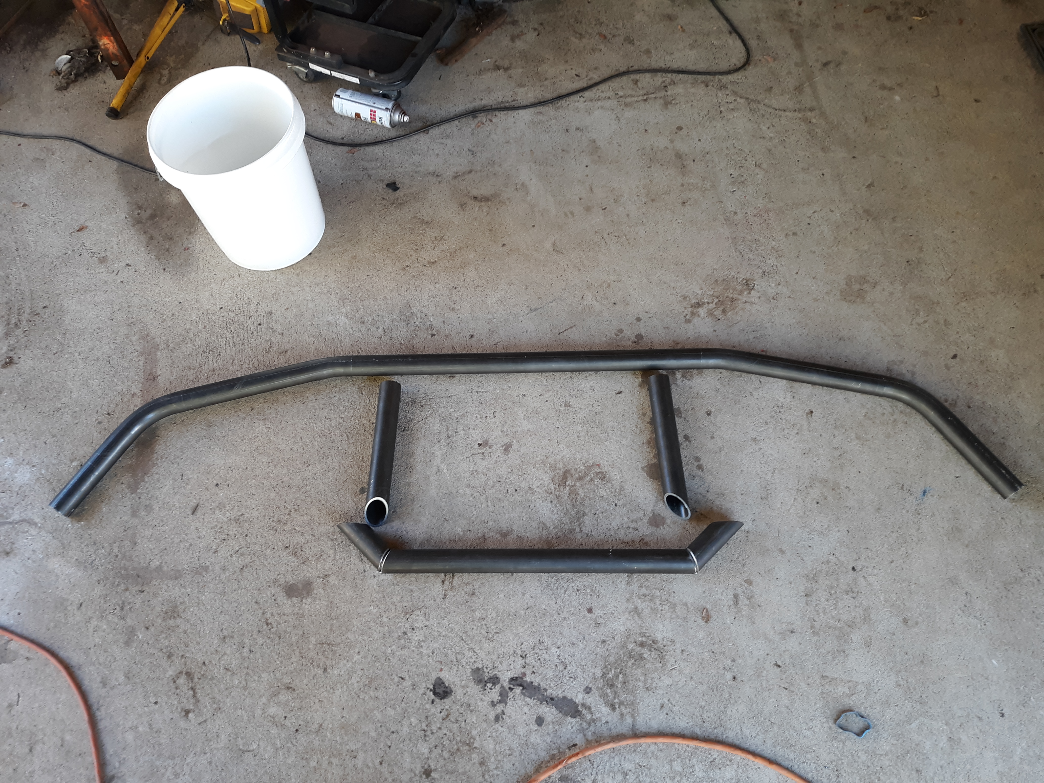

Back to more "fun" work.... with make a front bumper day. Got the main tubes made.

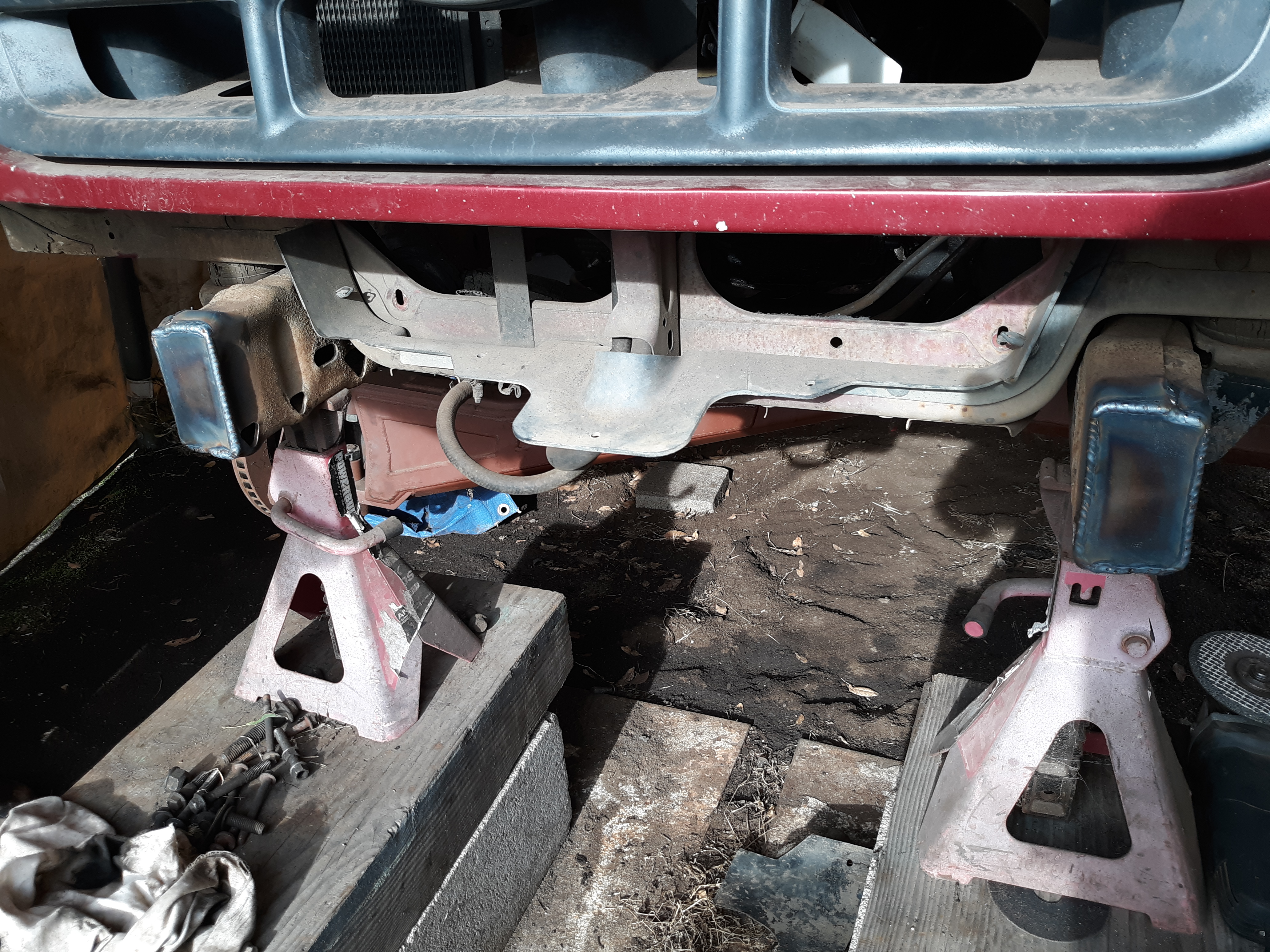

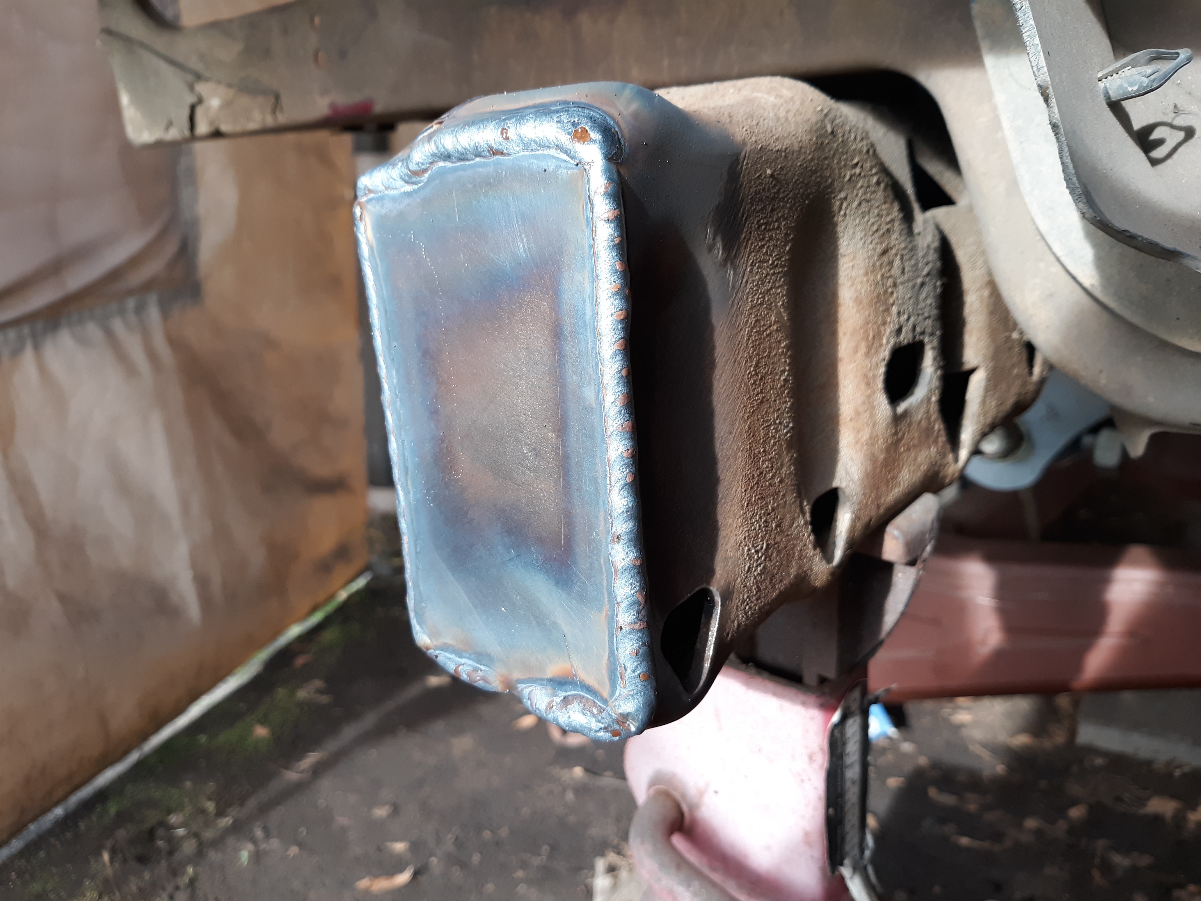

Then got the plates to cap frame rails done.
Weld those on..

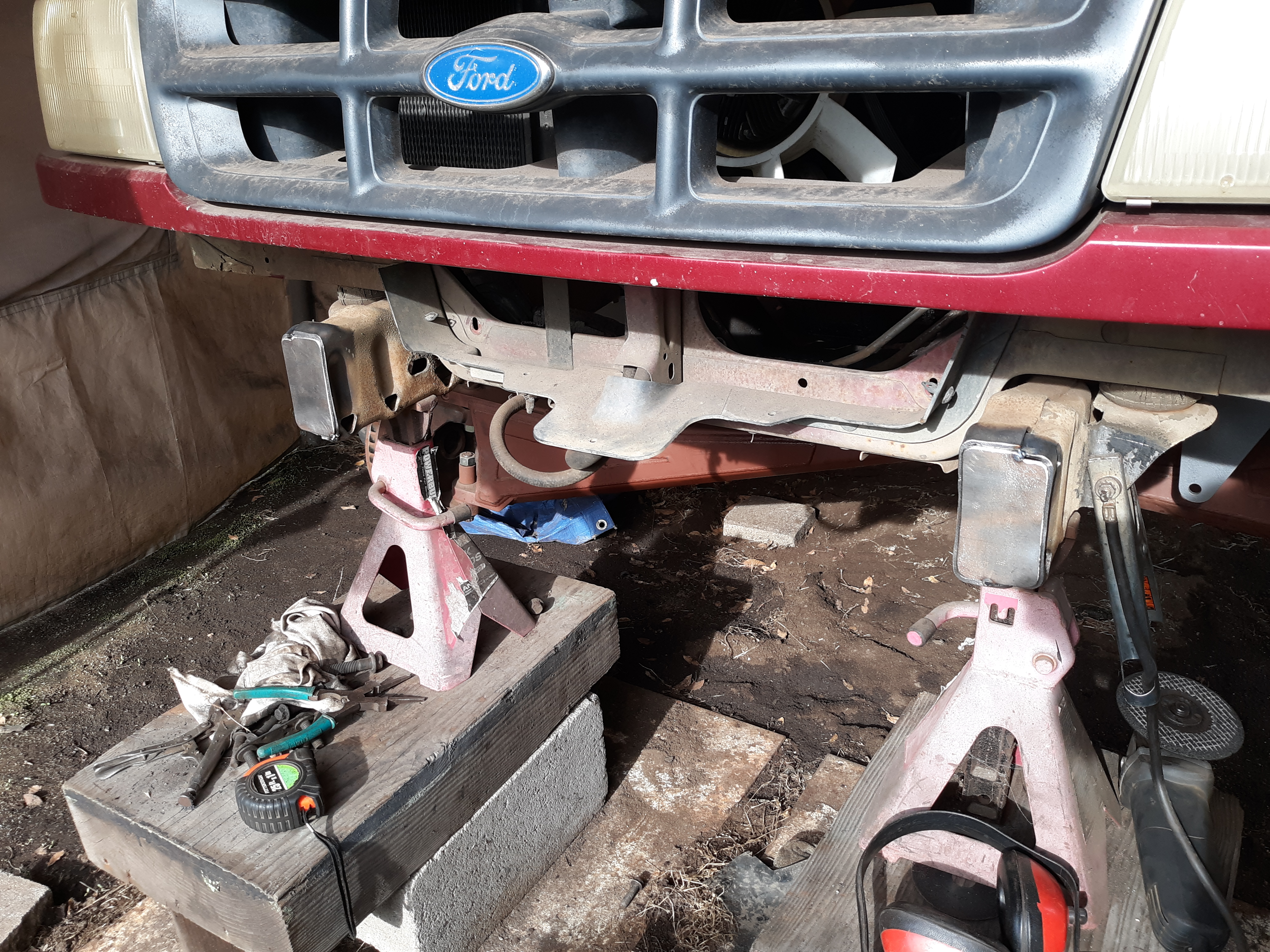

Then get the top tube level and tack those in. Then get over it and decide to finish installing the lower tube later. So... quick anti rust tape job so my joints stay clean. Until next time....
