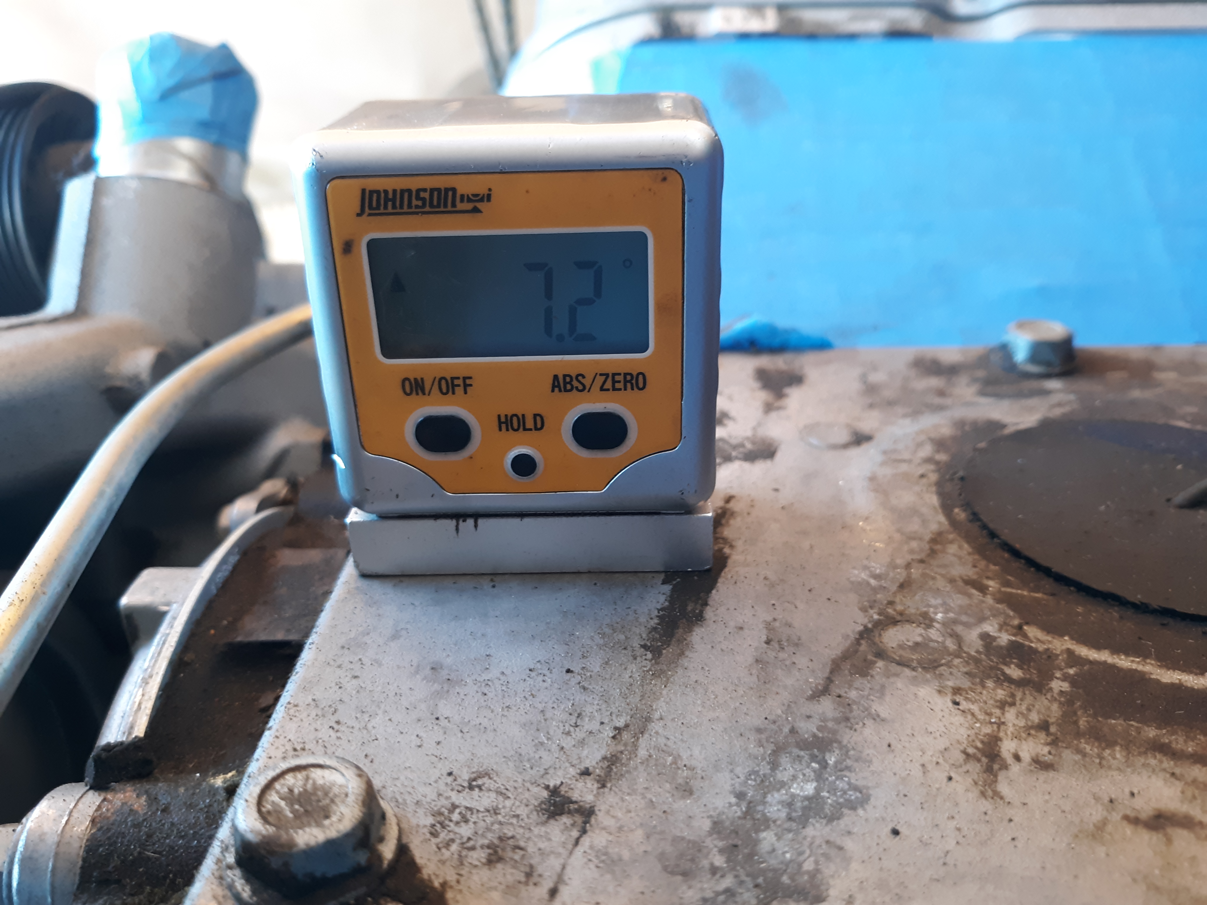

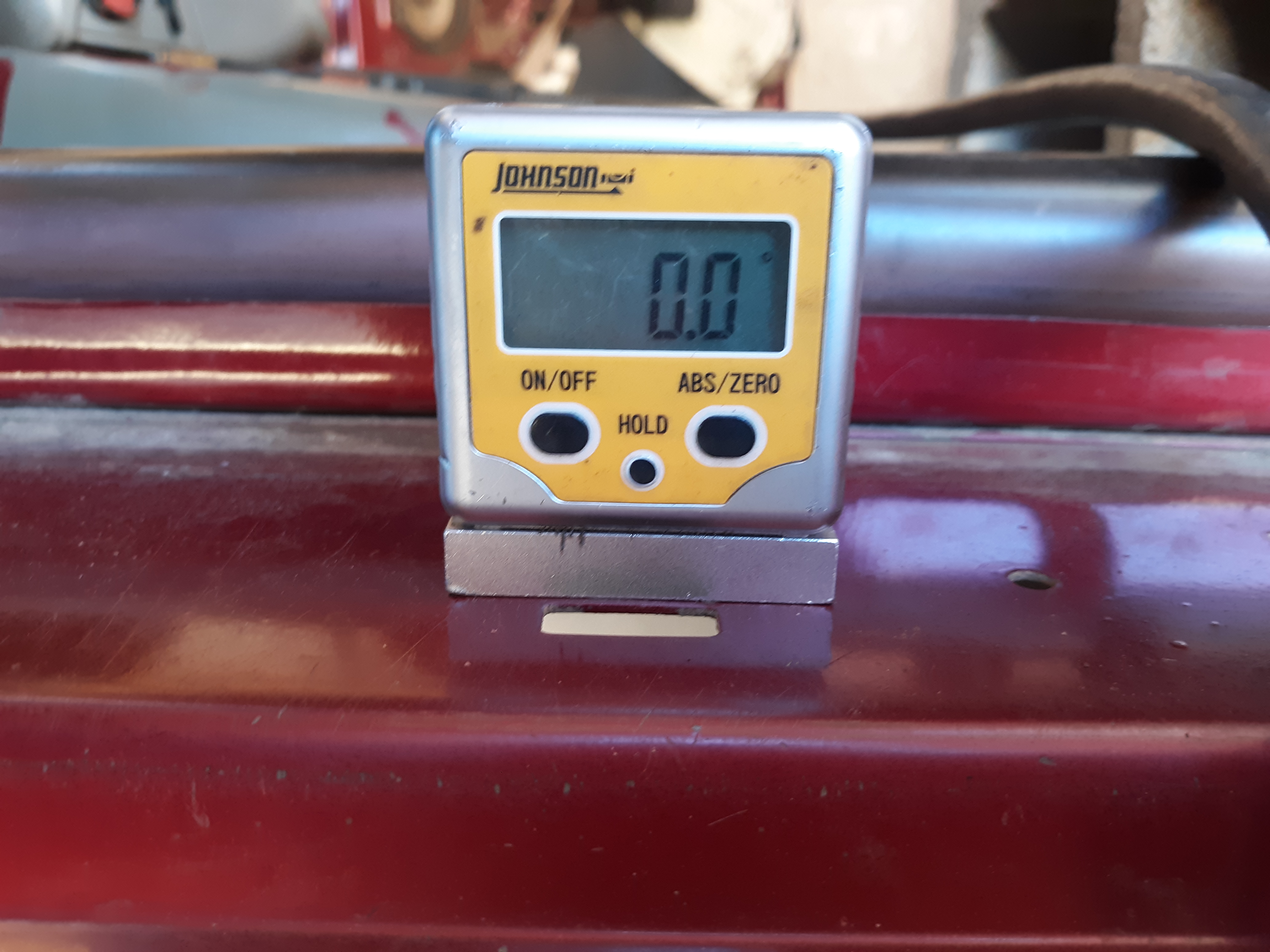

Here is the direction I am thinking at the moment. I will remove the front accessories and push the motor back so it is real close to firewall. I will also lower the front of the engine to get the angle a little better. Right now it is 7.2* angled down in back relative to the door sill.

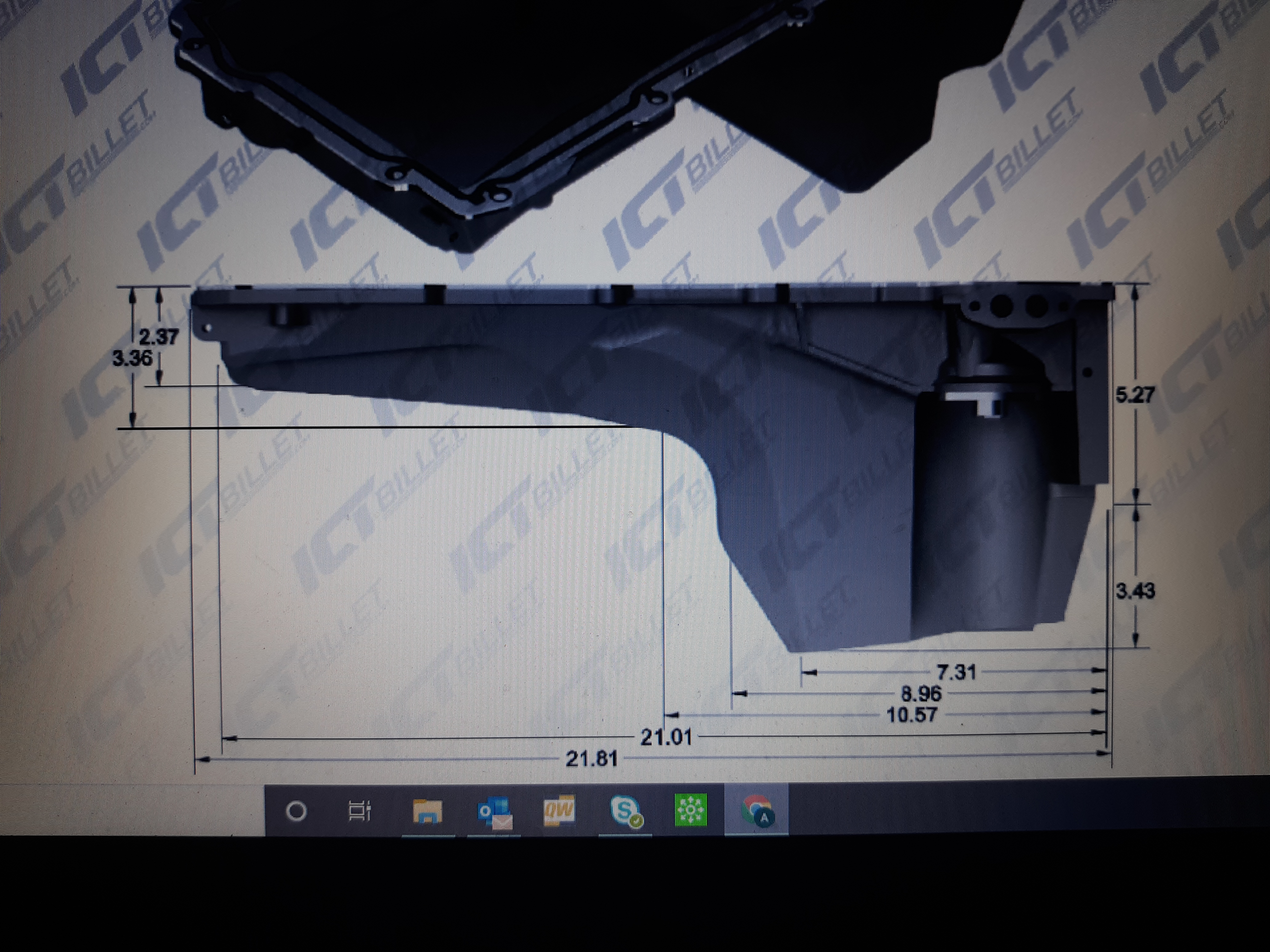

If this doesn't clear the oil pan... I will look at the options. It appears the Holley 302-1 would indeed save me about 1.5". And I have a hunch that after moving it back 2" or so... that might just be enough. Here are some dimensions from ICT site. I noticed that depending what site you look at.. the 302-1 has slightly different measurements. But they all seem to show about 1.5" difference from the factory pan. Must be the Brenthel tape measures out there? LOL
Stock LQ4 oil pan from 99-07
and here are the specs on the 302-1
It looks like there is a knock off of it available too on FleaBay... but I am a little wary
