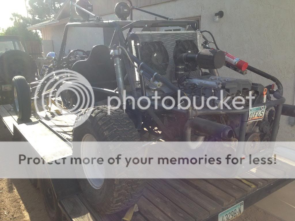

So while she sat around, I started planning what I was going to do. Figured I’d start looking for a 2d mendeola if one came up, otherwise I’d just rebuild the 091. Gay boy jake’s dad was yanking 2d out and we made a deal on that. Perfect, now I couldn’t just throw a larger trans in without more power. Decided to put a gen 5 m90 supercharger on the 3.2 and use an AEM plug and play computer since the stock one can’t be tuned. Got 410cc injectors coming and a 4 bar map sensor. Hoping for around 280-300rwhp but we will see. Dyno tuning time come when done.
In the mean time, bench seat is coming out for two re-upholsterer kids seats (these are not the jr ones they sell now, they are the older ones that are larger and give the kids room to grow into), going to fix the chassis and add more support, lower my front seats (always been slightly high), and some other junk. I got a dual disk 8” clutch from papa Gort as well which I’m going to swap the flywheel for a Honda unit and use. Will be plenty of clutch then for the power. Going to put the optima in my tracker and put an odessy 680 under the kids seat. The current mount is in the way for chassis bracing and I don’t have shit for room to place the optima anywhere else.
Yesterday I started tear down. Trans out, bench seat out, cv’s gone, clutch out, exhaust off and started measuring. New trans will push the cv’s toward the front 1” so I’m going to push the engine as fsr bad as I can, about .5 to .75”. 2d is also 2” narrower at the cups overall so longer axles are needed (big plus). Only issue I see so far is fuel tank sump may hit the trans top but I can move it up some.
May need to up spring rates but we will see. I wanted to re-valve these shocks again anyhow. Needs more bottom out control

That is a horrible place for the radiator. If you ever have in issue with it it's going to hose the rear seats down with boiling water. I have seen this happen and it's something I will never forget.
